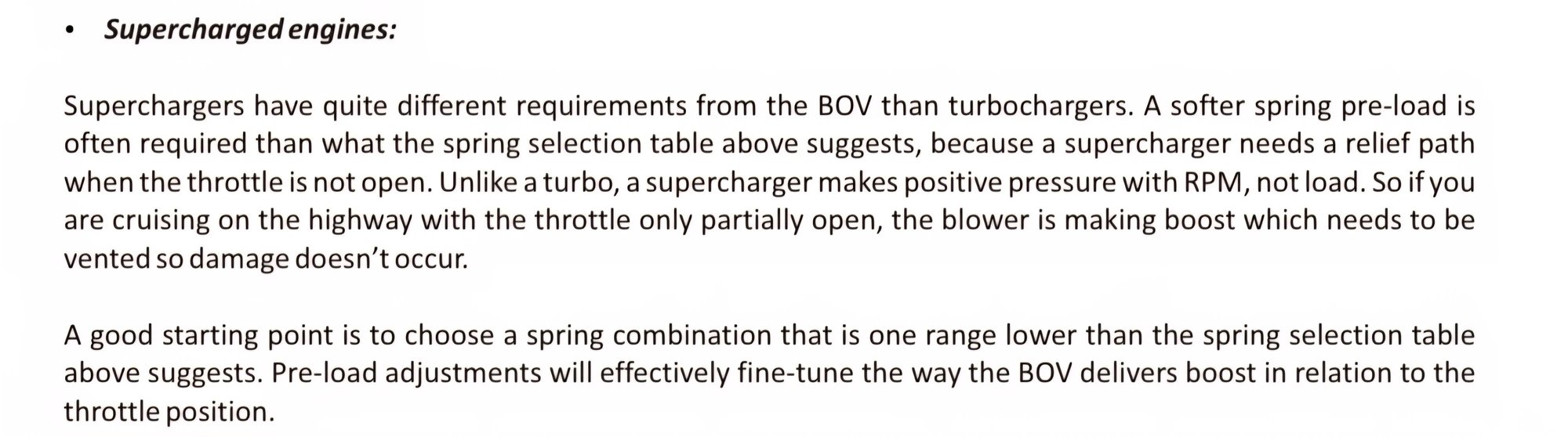

Let's say for arguments' sake that in my configuration the blower is adding more air than the engine requires for idling at 800rpm, and I'm not venting any excess pressure. If nothing in the tune was changed, my engine would be idling high/too high. You could then lower ignition timing to reduce torque, which lowers rpm. So it's entirely plausible that my tune (which I do play around with a lot) is balancing a no-vent at idle scenario.
@dark I know we're going to agree to disagree on this, and I'm not trying to stir you up, but it doesn't need to be supercharger specific bypass. The function any bypass performs is relieve air, and in the case of the Kompact that I use and Matt will use, it can be dialed in to behave however you like (recirc/atmo/spring pressure). Unless there's some other function we haven't discussed/and I'm not aware of, I don't know what you'll gain from one?
The main difference according to the articles I read was flow and response time, but I do kinda agree with what you said, they ultimately do the same thing, and it VERY much depends on your setup and tuning.
Taking our opinions out of the equation, if Turbosmart and GFB are stating different requirements AND sell supercharger specific valves, I must think it is for a reason, so that's what I will run as I'm a strict person when it comes to drivability.
