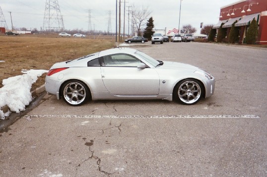

Here are a few pics of my TTZ created by Godspeed Inc. in Novi, MI. I want to thank Dan, Mike, Evan, and all the other guys for doing a great job with the install and tuning.
The pics are not the best, but they will do for now. 4 wheel Stoptech kit in blue should have shipped out from CA yesterday and I post more pics after they are installed. I'll post the dyno sheet later cuz its at home with my Z. Also planning to add front and rear spoiler real soon or possibly a full body kit.

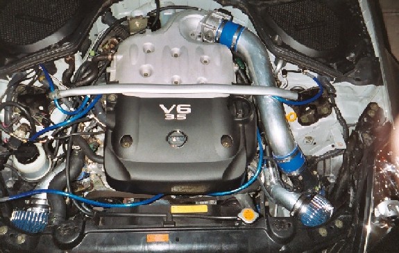

Sleeper

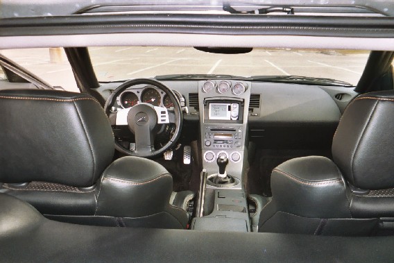

E-01 and Greddy Gauges in stock location.

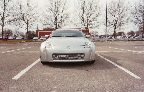

lowered

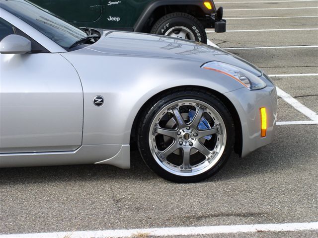

Cropped Blue Stoptech caliper on my Z. Can't wait till they show up and are installed

Did they set you up with a few maps for the E01?
Did you get an O2 or EGT?

Also, how well does the E01 fit in the stock nav location?

E-01 fits great and allows him to keep remote in there and still shut the little door. He has an EGT gauge which is what we recommend. The E-Manage has a tuned map for 6-6.5 PSI and for 8 PSI. The settings on the E-01 are set to those boost pressures. I sent the boost signal from the E-01 to the e-manage with the optional harness wire and then tuned it using boost value as the vertical scale on the map. I no longer use the MAF sensor at all. I just clamp it and leave it at WOT.
