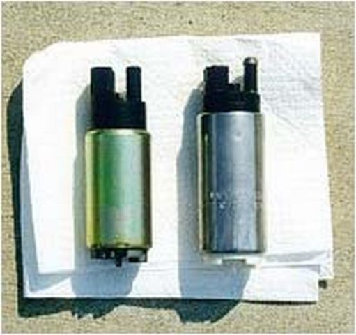

Stock is on the left, Wlabro on the right, this is a direct swap pump.

THat is the pump but it is not exactly a direct fit. The picture above does show why.

I think someone tried that pump in their car, or a Supra pump and found it did nothing because of our returnless fuel system. I think Skidazzle told me that, maybe he knows more.
Old Mar 12, 2004 | 11:51 AM
spazpilot's Avatar
spazpilot
Posts: 963
From: Carrollton TX
I don't see how that pump can do nothing. the walbro pump will most likely flood our fuel system. That is why I will be buy a FPR and make a return line. our pumps run 140lph and the walbro is 255. So I can almost bet now my system will run really rich when i install this pump. Skidazzle's setup is totally different then max and I. he is using the inline pump to over pressurize the fuel system. Max and I are losing fuel pressure at the top because our stock pumps can't maintain the stock fuel pressure. We have the program built in, its just not getting enough fuel. Cheston is running the same ecu program as I am (from what I am told) and the only difference is that he has an after market pump. His a/f doesn't start to go up after 5100rpm. Once I finish with the pump I will try to redyno sometime next month to see it was a waste or not.. Hoping it isn't and will keep people posted. CJ

Old Mar 12, 2004 | 12:11 PM
ravaz's Avatar
ravaz
Posts: 919
From: Raleigh, NC
Ok now your talking about running a return line, I'm talking about on a returnless fuel system. There was a Maxima guy that did this on his '02 Maxima, same thing as our car, returnless. It didn't do anything but raise the fuel pressure a little bit.
Well I'm pretty sure they did this BEFORE they ran the inline fuel pump, and it did nothing for them, thus the reason they went with the inline fuel pump, to raise fuel pressure. Like I said I'm just the messanger, I haven't tried this myself and don't plan to.

As far the the pump goes it's already on Yancys car and his runs great I'd say, making over 400hp.
He had it tuned by Guru so he's the one with the answer if this will drop in or you need to shave Pulse width off at low loads/rpms to make it run smooth. It just depends on the reserve flow left in the FPR in the tank.
Bolting the Pump in isn't hard you just need to tweak the bracket or make your own to make it work.
Gary

you got RAPED ont eh price of the pump dude.......everyone and their brother sells it for under $100.00
You'll see what happens when you go to measue fuel pressure after the pump install...fuel pressure will still drop even with this pump. Flow of the pump is not the issue, its the overall design of the stock system that is the limitation.
