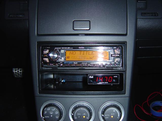

got it from http://www.machv.com/wio2sekit.html Great company, fast shipping. The one they show is just a digital readout, which is what I got, but it also has an output wire to go to a data logger and a wire that you can splice into the ecu if you don't want to add a bung for the sensor. You can replace the factory narrowband sensor with the wideband one, then run this wire to the ecu instead of the original narrowband. I already had an extra bung, so I set it up stand-alone. The company's website also shows some new models with wireless datalogging ability.

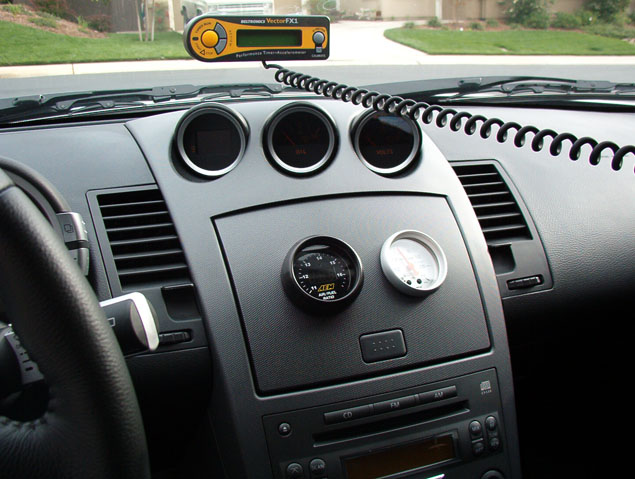

nice........here is my AEM wideband

now the question is, what the heck am I looking for on it???? Its really only relevant at full throttle, correct, since its around 14.7:1 the rest of the time?
yes 14.7:1 is perfect burn with no load such as freeway driving, idle etc. Emission freindly........ Under load it should start to read correctly.

Your sig stays stillen SC. Do you have that installed? Running stioch with FI is kinda wild. You shouldn't be that lean.
14.7 is 'ideal' stioch for gasoline to burn, and your ECU will try to adjust to make that happen (closed loop). Under WOT, the ECU will go open loop and go on pre-programmed values. Thats where normally on a N/A car you want to see if your mods are causing the car to run rich or lean.
Is that the A/F you were tuned to, or is your stillen install a pure bolt-on?
Old Apr 4, 2004 | 06:16 PM
2003z's Avatar
2003z
Posts: 4,959
From: Atlanta
stillen is a pure bolt on. I'm gonna have technosquare fix the fuel issues as soon as I have a wideband dyno done. the 14.7 is at idle and light throttle. It drops down a bit after that, but still a little lean for my liking.
about 13.5 at 2000 rpm to 12.5 at redline, under WOT.

FluidZ: Can you still open the Nav door with those gauges like that? If so, what does it look like when opened?
Old Apr 4, 2004 | 07:18 PM
fluidz's Avatar
fluidz
Posts: 794
From: Vortechville,CA
dont have any nav there, came as a empty hole, if you open it you see wires, but i would never open it because there is nothing there and it useless space unless you want to put some change and a garage door opener in there so they can clank around...LOL...........
