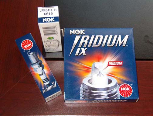

plugs one step colder
Attached Thumbnails F/I  guys..whats your plugs gapped at ?-4444.jpg

Anyone know the model number of the Denso Iridium's that are one step colder?

Mine just went in today at .38. Thanks to Max I got the right part number for NGK irid plugs one step colder... LFR6AIX-11
