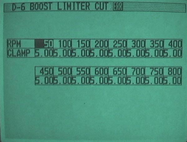

here are the ones etx posted gq
Attached Thumbnails ETX---I am going to initialize my eManage--Help-greddy-map-1.jpg

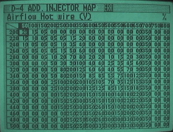

and the second one
Attached Thumbnails ETX---I am going to initialize my eManage--Help-greddy-map-2.jpg
ETX: Take a look at this fuel map. I find this very odd.
Look in the column "600" and follow it down as the MAF voltage increases. Notice how as the voltage increases, the map gets richer, but then suddenly gets leaner, for two cells....then richer again. The same pattern is present at "650". Why would the eManaged be programmed to get leaner at this point..then rich again? This doesnt make any sense to me. I noticed this A/F curve while making WOT runs, and monitoring my wideband. Between 5500-6500, my A/F goes from sub 11:1 to almost 13:1. Of course, I am using 100 octane gas for these little WOT tests...just to me safe.
Any thoughts?

Well the numbers in those boxes are all relative. It's adding a percentage of fuel, so really it depends on what the ECU is doing as well. This is kind of hard to tune to, but in the end it retains the advanced functions of the ecu. The ECU adds fuel based on load / intake air temp, etc. So because the turbos are adding air, the emanage adds a percentage of fuel. Err, It's hard for me to explain. For example if it's colder outside the ecu naturally adds a little more fuel, then the emanage adds it's percentage ultimately resulting in a lot more fuel than the motor would get if it were warmer out.
That is why the numbers in the map may not make much sence. It's just adding a percentage of fuel, that's not an absolute fuel measure. Say the ECU is opening the fuel injector for 10 ms per rev, the emanage sees 30 in the map so it will add 30%. 10*.30=3 + (plus origonal duty) 10 = 13 ms total

So if I wanted to add 10% more fuel from 3500rpm-6500rpm, would increase the values by 10% in all the cells for 3500-6500? I just cant see an logical pattern on that map.
If I recall correctly, I think you were the lucky dog that had an unlocked eManage. So I assume you pulled this map down from your eManage...and this is the stock Greddy map. Right?
Yep!
The irratic map values are because of the stock nissan programming. It's one turd on top of another.
