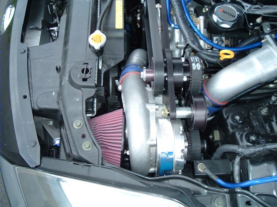

Here's the spot I had rubbing. The serpentine belt rubbed against the head of the bolt in the picture due to the way I had threaded the belt.
Attached Thumbnails Vortech belts VS. ATI belts A LITTLE CLARIFICATION-rubspot.jpg
Old Apr 24, 2004 | 11:12 AM
zimbo's Avatar
zimbo
Posts: 970
From: NC
The pulley in this photo has grooves. I had the belt in the grooves too close to the edge of the bracket. When I moved the belt over to the outer edge of the pulley (i.e. correctly in the grooves), the rubbing went away. This was user error, not a Vortech design flaw.
