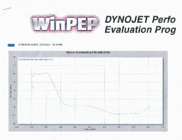

If these are the right pulleys then the car needs to go back to the dyno to make sure the A/F ratios are OK. AT 8.2 psi the highest it got was 12.8. At 10 psi I am not 100% positve the A/F will hold? In which case the flash and fuel system need to be evaluated.
I would agree with you there. At 9 PSI I was 12.2 at the highest point *before* adding the larger fuel pump.
Yeah I saw Doug's headers, pretty sweet.
