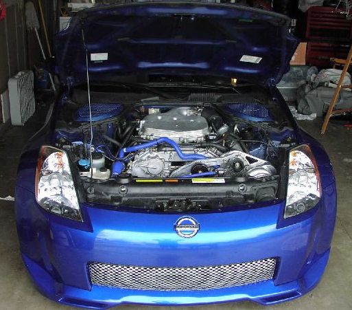

Exactly 9 PSI on my ATI kit (finally), and it's a daily driver, it is finished!
After a long weekend last week it was determined that the tractor belt (lol) that I ordered wasn't gonna work. It wasn't flexible or giving enough and was actually shorter, not longer.
We tried one other pulley combo and still made 10 pounds.
It was determined we needed to lose one tooth, the only way around this with the belt size being one size fits all is go with a
*38* and a *25*, this dropped the ratio one more tooth.
I turned my car into Nissan for 3 days and went about my work week and let them do it because the jack shaft pulley has a habit of sealing itself to the shaft and is extremely hard to get off (I had a 41 there.)
Future Nissan in Roseville , CA. went all out man! They first fixed my torn bumper by replacing it with a brand new one. It had torn several inches on the drivers side where the FMIC IC pipe bows it out. Then they cut/shaved the area from preventing it from happening again. Then they take my Stillen II front spoiler/lip and Stillen race grille and put it back on and sand and repaint the whole front of the car including the sides and hood! Needless to say the car looks brand new again, no rock chips, no cracked bumper, bo scuffs on my lip. Several people here have seen my torn bumper and know what I am talking about.
Charge for all the body work? ZERO! I am writing them (Bryan (Mechanic) , Tom (Manager) and Ross (Service Writer) a very nice letter of thanks.
Not just that though, there is a bolt that can rub slightly on the shim (tensioner) and that was very slightly shaved (they got this tip from Walnut Creel , CA Nissan who is going through lots of belts like I was.) So they shave my bumper, pull the compressor and bracket, swap my pulleys, add my belt, thread lock everything and then the mechanic Bryan goes for a ride with me to help me watch my gauges. In D from a dead stop to WOT it was exactly 9 PSI at 800C through first, second AND third! We were flying. We did some manual mode runs that we just nuts.
$200.00 bucks and they had my car 3 days! I couldn’t be happier with Future Nissan in Roseville right now to be able to not only have my car purring like a kitten and have the Kit complete to where it was flashed at, but a new front end paint job and bumper too?
I then drove my car all the way to the Bay Area for work and never strayed over 8-9 pounds, IT'S PERFECT!
Finally! I still want a fuel pump and they have an angle on that they are working too that flows more; it can't hurt since I have larger injectors. I am definitely going to buy one, it's being researched as I wait.
I should thank my friend EJ from here, Technosquare, Tadishi, Danny, Victor Reyes of RB Motoring, Eric of ATI , Performance Nissan, Cheston and Doug @ Crawford for either service or parts or just encouragement and sometimes all of the above. EJ and I have been battling this boost level from 6 pounds to 11 pounds and it was a combined effort to get it done but without all of the above it wouldn't have happened.
I feel very comfortable boosting now and my EGT's dropped back down again. I think 8 PSI is the sweet spot but 9 is just fine for me right now until I dyno and track and add a fuel pump, then I may go back down to 8 PSI but I doubt it, the car runs perfect.
I am off for 3 days and will find a Dyno Monday. I expect 400+ again it smokes the tires for several feet. I am up against trying to find a Saturday track event though due to my new Tues-Fri swing schedule, no more Wed or Friday nights but I know my track does some Saturdays, have to check their schedule.
So for those discouraged, doubtful or wanting FI, if you have patience and faith you will meet your goals.
Disclaimer, I lost an engine before I learned how not too, what works for me may not work for you, I just post this to show it can be done, and ways you can avoid losing an engine like I did to get there! I did it backwards but everything happens for a reason and I just felt that I should share my story as FI grows more popular, it can be done safely.

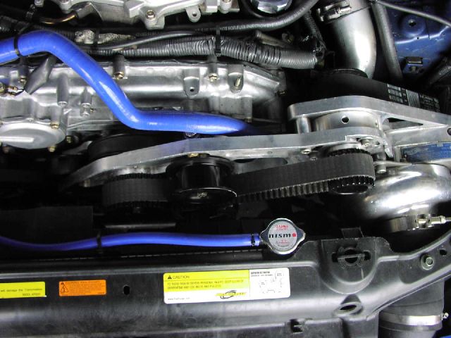

#38 on jack shaft pulley, #25 on upper driver side boost pulley.
Technosquare reflash to add fuel, even out air and retard timing
Keep it cool, check your fluids, watch your belts and guages.
Run the belt under the tensioner with this pulley combo.

Close up of new pulleys and belt.
See the gold colored bolt above the tensioner pulley (shimmed?)
It can rub on the shim and has cause lots of torn or shredded serpentine belts per Nissan, they fixed this to allow more clearance on mine. The belt will be too big with this combo of pulleys unless you go under neith the tensioner, ATI says either way of routing is ok.
