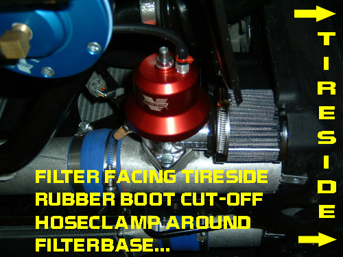

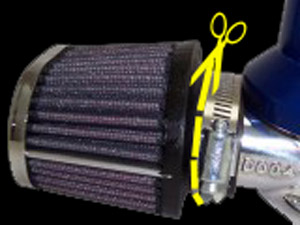

the first thing i did was to flip the BOV outwards, but in order to make it fit within the wheelwell, i had to trim therubber boot off, and then push the filter onto the trumpet further...
the oem clamp should still doe the job, being placed on the filter shoulder (see pic), still giving a good seal, and allowing much closer filter location..

heres what it looks like, mounted wheelside out, with the trimmed boot....
(minor trimming of the fender cover (plastic) to make it fit in REALLY snug)

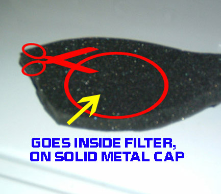

next, i sourced some sound deadening material, and found that air filter foam works very well (and allows the air to pas thru still).
i bought a big piece of this from autozone, sold in a box with just the circular-like shaped piece of foam
below is pics of it already hacked up....

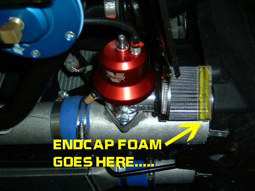

NEXT, you wanna cut a piece of the foam to fit into the endcap of the filter (this makes a very big audible change).... i didnt adhere the faom in, just jammed it instead (cut it a bit generous)

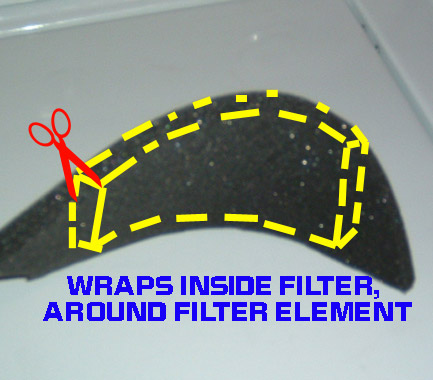

NEXT, i cut a rectangular swatch of faom to surround the interior element area (kinda like the oem filter element does), and then lined the filter body with this...

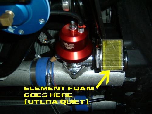

heres a pic of where the second foam piece resides in the filter body....

i decided to only do the endcap piece of foam, as it was almost too quiet with both pieces in there....(can you imagine??)
depending on the thickness of foam you get, you may wanna do both.....
MAKE SURE to get an airfilter foam, that you can breathe thru (good test to see if it passes air) because we dont want any blockages of volume (just sound)
