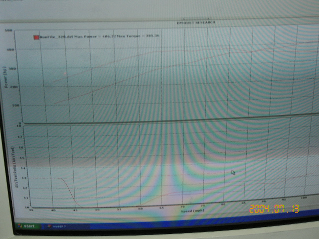

Well today i tuned my car after 2weeks of waiting after i got my kit done. the reason why i has waiting so long its because i send out my computer to get re-lfashed and do a couple of things more. my results were awsome wich i made 406 at the wheels and 385 of torque at 8psi and 6800rpm's i really happy with the numbers. and i got my new wheels in today so i cant ask for a better weeks than this. i have a couple of pics of the dyno sheets but there not that good i will get better ones soon here they are.
this are my setups:
Greddy Twin Turbo Kit
-ASR Engineering Custom Fuel System
-Digital FMU
-Upgraded Intank Pump
-Additional Inline Pump
-Larger Injectors
-G-Force ECU
-Recalibrated Fuel Map for Larger Injectors
-Recalibrated Ignition Map for Boost
-Recalibrated TPS for Quicker Throttle Response
-Speed Limiter Removed
-Greddy Profec-B Boost Controller
-Custom Molded ASR Engineering Center Guage Console
-Carbon Fiber Autometer Boost Guage
-Carbon Fiber Autometer EGT Guage
-Carbon Fiber Autometer Air/Fuel Guage
-Custom Stainless Steel Downpipes and Y-Pipe

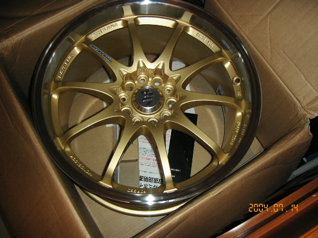

and i got my new wheels in so what better day than can i get (lol)

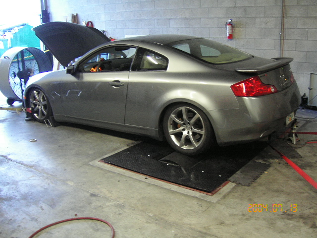

this is a pic of my car at the dyno

SWEET!!!
(wheels and numbers)
and yes, that dyno pic stinks..... lol
i think i recognize that DJ dyno.....

the dyno session was take in south florida the shop name is speed lab. and sorry about the pics i will have new pics tomarrow the didnt have no paper to print it out lol

Nice Numbers what suspention mads did you do because your car looked slamed!

[thanx to everybody for the replys and my car is drop on hks hyper max coilovers.]

very nice number... The only thing that you may want to play with is straightening out the a/f curve.... better numbers in the low-mid range are to be had...
