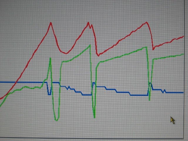

im not making much if any at all below about 3700 rpms. my recordings on my software shoot almost straight up at that point so that must be where mine kicks it, but i swear i can feel it before that.

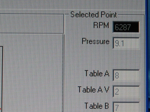

actually after playing around with the recordings and finding the highest boost, it seems to be 9.1psi @ 6287 in 2nd, damn thats impressive dont ya think? still got another 500 rpms to go. i bet if i had the TS 7100 flash, id be near or over 10, does anybody know if we can post these recordings? also i still cant see anywhere that im making boost down low like you zimbo.

here are the pics of my recordings, i couldnt figure out how to copy and paste them, so i took a pic of them,

here is a pic of the 9.1psi

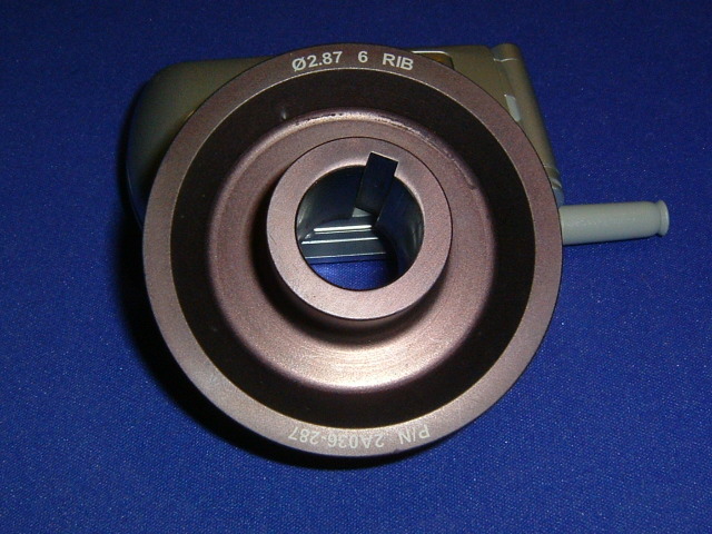

if you decide to go down a size (from 312) this is the next one on the list....
i plan to pull a ton of timing up top, and add in fuel above 6K...
then we'll see the dyno readings (and i will stay hooked up to the laptop i guess)..
damn, wish i knew more about the r4; i woulda been all over recordation of runs (knew of realtime viewing, but never thought one step ahead!)
so anyway, after talking directly to vortech, and confirming with my tuner (AND dealer), we are gonna try to make more on the low/mid, and retard up top thru ignition (for now)...
id prefer to shift sooner anyway, as the TQ drops a lil above 6200 rpm's.....
guess the 'cat's outta da bag'
