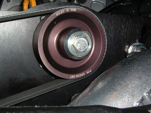

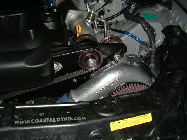

anyone wanna know what the 287 did for me???
i also found a 92.3" belt, that is damn near perfect for this size...
wow...
double digits BEFORE redline.....
neat!!

lil mini-me.........

to clarify::
