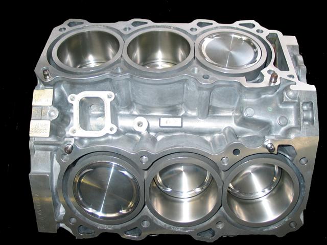

here is a pic of the vq block you can see how nice and thick the factory sleeves look.
As far as bigger valves are concerned im not convinced this is necessary. After much discussion i ve been told several times that these heads are some of the best factory heads ever designed for a production vehicle.
They really will benefit from a cam which offers higher lift and longer duration like Jim Wolf Technology cams. This cam has been reccomended time and time again for FI vehicles.

Nice picture! I have heard that the two weakest parts of the engine are 1. the rods 2. the valves. I guess we'll have to do soem research and find out the failure rate of the valves in high power applications.
Kevin
