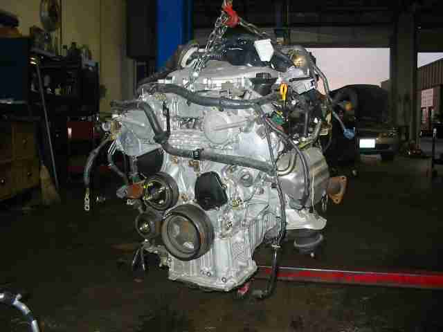

Well, I had decided to quit engine upgrades one I had my Procharger installed about 1200 miles ago, but then this happened...

Yeah, although the engine currently Procharged in my G35 is running fine I bought another engine. The engine came out of a 03 G35 sedan that had been rolled, but the engine is not damaged in any way. The only catch is that i had to buy the engine and the auto tranny as a set, as the seller did not want to break them up. So, besides having a spare auto tranny for my 6mt everything worked out really well.
Now, to the issue at hand. I know I want to keep my Procharger. I talked to Procharger and they say they have pullys to safely take it to 24psi. My goal is to get the engine to run at 16psi everyday. I know I'm definately swapping pistons/rods and crankshaft, along with getting some head work done.
I'm also planning on replacing my 380cc PE injectors with the bigger ones. What CR should I be looking for for this setup? It seems to be split down the middle with some people saying take it to 8.5 while other people say keep it at 10.5.

build it supersmart bro... this is a unique experience/opportunity, that you really should take full advantage of...
l/c pistons, Ti conrods (crower, or the like) and some serious headwork......
also, having the crank balanced and bp'd would be a good idea......
once done, you could offset some of the cost by selling the stocker VQ...
i gotta ask... are you 100% comitted to the PC?? with the risk of sounding unhappy, i wonmder if this isnt a chance to try another F/I methodology such as TT..... (mimick the r34, cept its inline)
nice bro.....!
im anxious to hear more, as the story unfolds (make sure to chronicle the entire process, so i can live vicariously thru you!!
((also, PC's claim of 24psi being 'safe' is borderline looneybin speak.... i cannot see them making such a statement, even with a fully built VQ l/c motor...))

Es, Kevin said that procharger has pulleys to run the blower safely to 24PSI, they said nothing of making the engine capable of this task. That is Kevin's job.

The thing is, is I am completely happy with my Procharger. I don't really see the advantage to spend another 10 trand to get teh TT. The slight power increase due to the absence of paraetic load arn't that important to me. I do have limited funds for this car, and by the time I buy all the forged internals there just won't be enough money left to upgrade to the TT, even if I get top dollar for my ProCharger, which I probably wouldn't.
Oh, and my goal is about 550 rwhp.

Crawford has done all the work on my car so far, but I'm not 100 percent sold on them doing the engine. I have spoken with Doug, and they can do it. But, they are awfully far away from me to be building the engine, asI would have to ship it down there, or to their guy in Atlanta. There are quite a few local places that can build engines, and I'll probably talk to the guy that has been building engines for my Dad for the past 35 years.

so the impeller speed can support three times the oem setup, without revisions???
talk about over-engineering!!
how can the max impeller speed not be breached by tripling the boost levels only (pulley changes)
if i use the vortech calculator, (which is what i dont wanna do), i cant see this as possible...

Procharger used a 'generic' compressor for this application, it is their C-2 model. This model, according to their website, has a max RPM of 80,000, at which it will produce 24psi. I'm not sure what RPM it runs at for the G35 setup, but its obviously less. The tech I talked to claimed that they actually have pullies to run it at 92,000rpm.
http://www.procharger.com/models.shtml
So, as I stated before, I really can't justify going with the tt, also, I would have to give up my Crawford headers....
Procharger told me if I can build the engine they can boost it!
