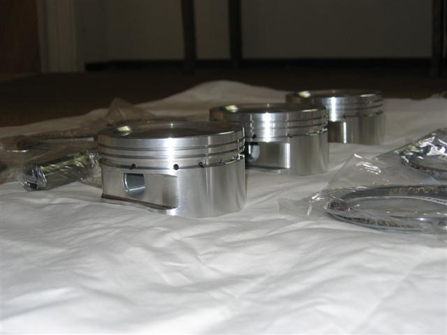

For those who got in on the Arias Pistons group buy mine arrived yesterday (8.5:1 CR). Here are some pics. 1:

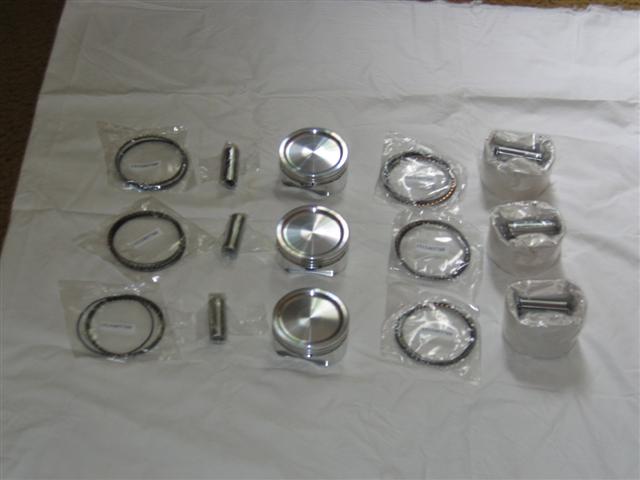

pic 2:

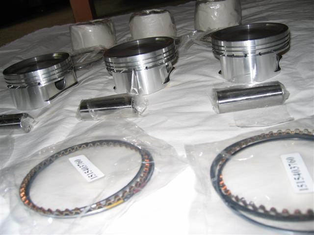

pic 3:

its so prettay!

Almost too pretty to install...almost.

Also, aren't there wrist pin clips included?

The pistons set includes pistons, rings, wrist pins, and locks...everything you need to install them.
