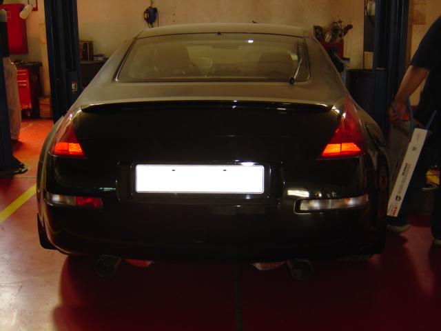

Here you can see that I blocked the rear emblem holes... bye bye emblem(s)
Attached Thumbnails Update: Ultimate Racing TT install-dsc00578.jpg

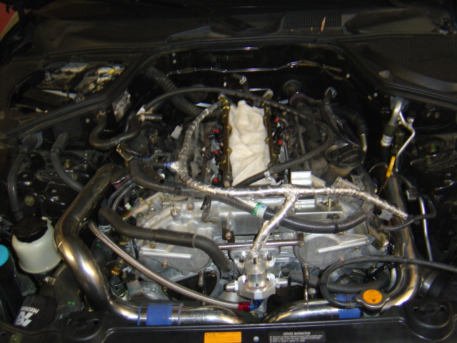

In the pic above you can see the fuel lines and fittings in the UPS box I got today. Anyway, here is another pic of the engine bay
Attached Thumbnails Update: Ultimate Racing TT install-dsc00580.jpg

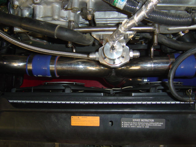

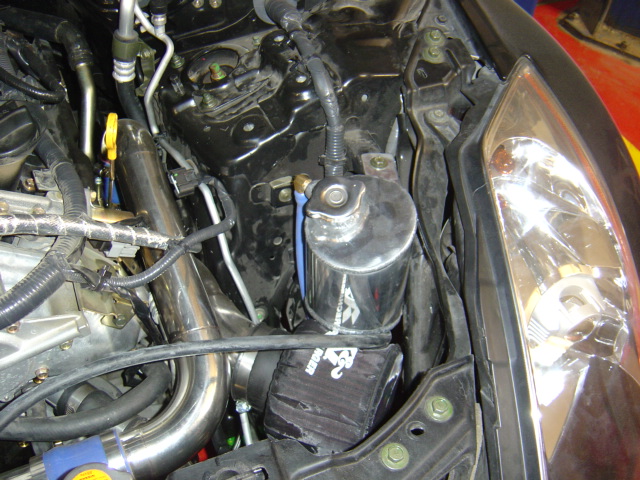

Radiator overflow tank
Attached Thumbnails Update: Ultimate Racing TT install-dsc00581.jpg

FPR and new fans
Attached Thumbnails Update: Ultimate Racing TT install-dsc00583.jpg

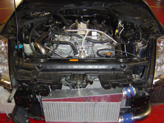

From the front.
Anyway, the car will be out tomorrow and I will be doing some fine tuning on the e-manage, and in about a week time I should take it back to install the Cusco RS LSD
Attached Thumbnails Update: Ultimate Racing TT install-dsc00584.jpg
