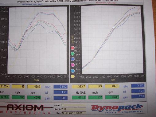

Well I'll cut to the meat. At 8psi it dynoed 411rwhp and 360 rwtq. This was on a Dyna pack dyno SAE corrected.
My set up is in the sig. The low TQ is from how rich the setup is. it was low 10:1 all the way until about 4800. I will post pics of the sheets here shortly. I'm thinking about leaning it out a little to see the TQ and hp come up alittle.
Gary

Here's the dyno sheet.
Attached Thumbnails Greddy Twin turbo kit with TS Greddy Flash dyno results-dyno-411.jpg

I think its running rich due to the Walbro 255. Have you considered running a raising rate FPR and simple return fuel system? The hardest part of tuning the 350Z is the irratic fuel pressure...makes it darn near impossible to get a steady and consistent A/F ratio.

With the TS reflash all my richness was fixed at idle and during normal drive and I get the same A/F every pull now. It has to be the emange that causes it to jump around like what your talking about. It did it before the flash each pull would look a little different in the A/F, but after it is very consistant. It has to be the way it interacts with the ecu as a piggyback.
I know what your talking about GQ, before the flash it would run rich alot even during normal driving but it no longer does that.
