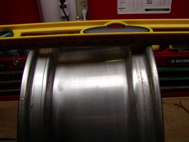

Actual size of G35 Coupe OEM 18 x 8 wheels. I've been told (on forums and at a tire shop) that the OEM wheel is actually an 18 x 8.5, so I measured the wheel and found that not to be true--it's 18 x 8JJ as you can see in the attached photo (hoping it appears after this text).

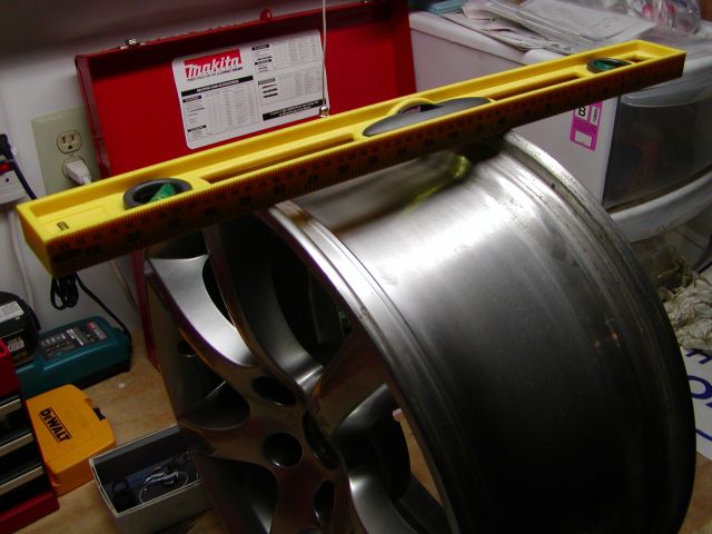

ruler is a bit more clear in this pic...

Thanks, sorry if I wasn't clear...I agree that the wheels are 18 x 8JJ +30mm offset. I've seen a number of posts where people said the wheels were wider (a tire dealer also), so I measured my wheels while the tires were off of them: 8" wide from the inside of the outer flange to the inside of the inner flange. According to a wheel designer at Enkei , that method of measuring is the industry standard (see link).
Here's at least one of the posts I saw that leads to a bit of confusion...I also posted in a thread on another board that a tire shop told me the wheels measure 8.5. It bugged me that I might be passing bad info (Internet parrot), so I measured my wheels and shot some pictures showing they were only 8 inches wide.
