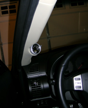

Does anyone know of any issues with mounting gauges on the A Pillar? I am installing Vortec SC and would prefer to mount on Pillar but not if it will impact Airbag.

I have an 2003, and molded in a pod into my drivers side a pillar, no issues for me...

Is there anyting underneath the A Pillar or is there good access into the engine compartment?
Thanks

Access to the engine compartment is from under the dash...

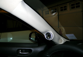

The only problem with those aftermarket gauge pods is they stick out so much... There's plenty of room behind there to flush the gauge into the panel, but it's a custom job...
