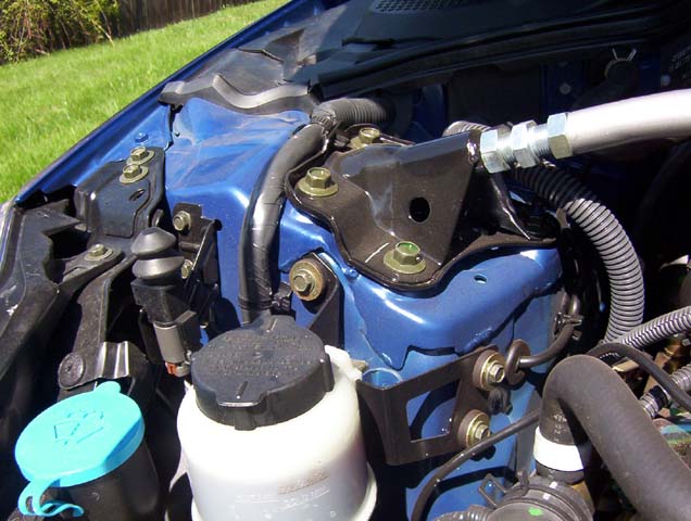

Question: Will your modified strut tower brace fit the G35 Coupe? A brace such as the Z's won't fit due to hood clearance issues, but it looks like yours should fit; may just need slightly revised brackets. Keep us posted.

The strut bar might work but you would first have to get the afterthought
nut plate brackets that are on the Z and weld them to the strut towers on your G

Happen to have a pic of what you are referring to that I can compare against my car?

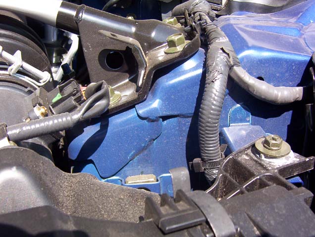

See the welded on pieces in these two shots:
Attached Thumbnails News for you G35 owners... wanting our plenum.-bar-mount_0198-s.jpg

Attached Thumbnails News for you G35 owners... wanting our plenum.-bar-mount_0197-s.jpg

If you noticed comparing my two shots against VandyZ's pick, those add on pieces that step up the tower area that the bolts go into I believe are what Doug means are not there on the G35C, so you'd have to have something fabricated to create the mounting surface (not sure you could buy those from Nissan).
It might just be easier to have somebody custom fabricate something shaped to bolt to the top of the towers of the G35C than to try to find a way to use the Z's mounts. Bar could be used, though, once the mount was there.
(Disclaimer: I'm not trying to speak for Doug or anybody else involved in these things, I've just seen what they are talking about).

Mannish that is exactly what I am refering to good pic of the nut plates might be able to order them from Nissian but I haven't checked into yet , put that on my lOTTD.
