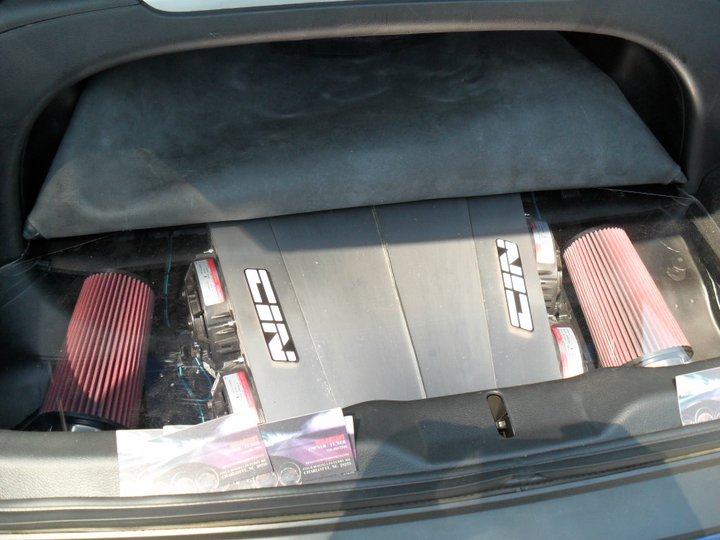

Looks like my build. The LS swap is the way to go. I'm loving mine!!
http://www.youtube.com/watch?v=SCRD0JR1Y4k
Attached Thumbnails Should have had a V8 Brew_haha's LSX swap-247365_10150332186293009_747483008_9749787_3963283_n.jpg   Should have had a V8 Brew_haha's LSX swap-225572_10150332186398009_747483008_9749789_5527946_n.jpg

Yea my friend Todd weld that was at zdays sent me all the pictures of your 350 from zdays my jaw dropped at the rear intercoolers.
