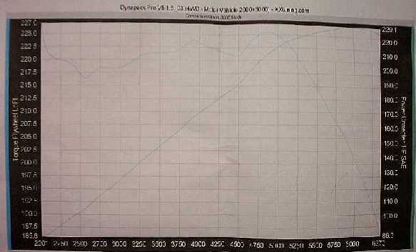

Baseline Dyno HP-229.1 TQ- 227

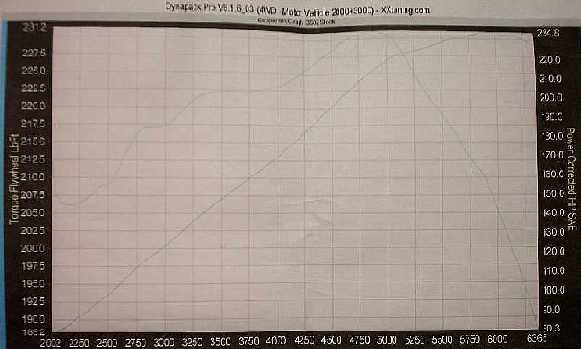

After the Z-tube HP-234.8 TQ- 231.2
Attached Thumbnails Does the Z tube really add more hp??-dyno-after-z-tube.jpg
