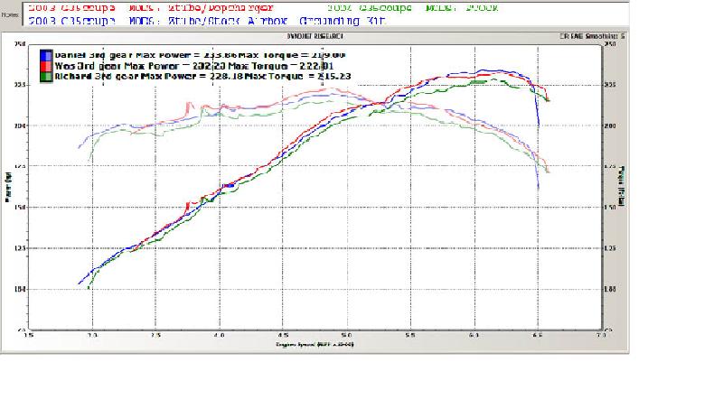

I'm relieved to see SO MANY intelligent people on this forum. EVERY G35 forum thinks the popcharger is GOD'S gift to the VQ35DE.
Yes people have dynoed it... I have dynoed it. Here's a dyno chart of 3 G35 coupes (all autos).
One was 100% stock (green)
One had the 350Z intake tube (Z-Tube) and the stock airbox (blue)
One had the Z-Tube and the Pop Charger (red)
Keep in mind the hoods were all open and a fan was blowing on top of the popcharger giving it a slightly unfair advantage...

Sorry for the crummy picture. The 75000 bite restriction is killing the image quality. If you PM me with an e-mail address I can send you the actual file.

Thanks man. I have recieved your email.
And as neffster dyno shows, a max increase by 4whp and 7wtq combined with the Z tube

And when comparing the "area under the curves" the popcharger (which is cheating) is equal to the K&N pannel filter with stock air box (which is being hindered).
On the G35, when the car sits at a stoplight, the engine emits quite a bit of heat. When you take off, initially the engine injests all of the hot air (ambient air) with the popcharger due to the half-a$$ heat shield. The stock airbox ONLY draws in much cooler air from the front bumper area, thus not bogging the car down. If you really want to experience this phenomenon, move to FL in August! I bet the popcharger will lose 0.2-0.3 seconds in the quarter mile when driving on the streets. (Although I'd never street race ).
