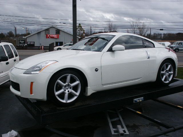

What does nissan do to make that extra 13hp but loose 14lbs/tq, on the '05 track edition?

i know thats not the track edition......i'm trying to get a pic of my car over by my signature.
