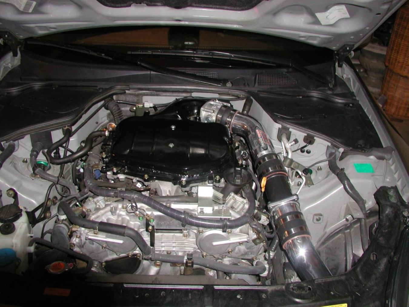

yeah the install is simple. Just unbold the factory airbox, then install the piping according to this picture.
There should be a little metal arm welded to the pipe that will be installed vertically with the filter on the end of it. That arm will be bolted to the engine bay by that bolt the kit comes with that looks like a rubber cylinder with two threaded bolts on either end.
Don't worry about this install... I didnt have instructions for mine, and the install was simple as all hell. You might need to jack the car up and take off the front drivers wheel so you can pull out the splash guard on the inner fender to tighten the filter on. Not hard though

+1 for easy install.
-After you unbolt the stock airbox, just pull gently upwards (it has 2 rubber connections on the bottom side that need a little force to pop them out...it took me awhile to do this b/c I was thinking I missed a bolts somewhere.)
-I agree with taking off the front driver side wheel and splash guard - makes it so much easier!
I've attached a few pics of mine (I bought mine used and put a bigger filter on it). hope it helps!
