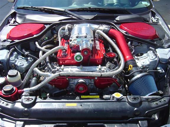

Can the Injen CAI be installed to the Stillen Supercharger. Stillen told me that I have to use their intake instead. I just like the looks of the Injen CAI over the Stillen CAI. Please help!

The only reason I can think of is the injen tube just barely rubs against the hood, but the stock tube does also. I am running the injen tube and a JWT popcharger, there is no reason why I can see that the complete injen setup wouldn't work. ( I have since modified my tube from when this picture was taken, just flattening the part that hit. It just needs to be re-powdercoated.

do you have the stillen hood or stock...if you have the stillen hood, will the intake still scrape touch the hood?

I have the Stillen SC and so does Mapleleaf. I bought the INtake from Stillen. I think he has the INJEN CAI. It will work just fine. They want to sell you their intake. I am looking at other intakes in the future for my SC.
