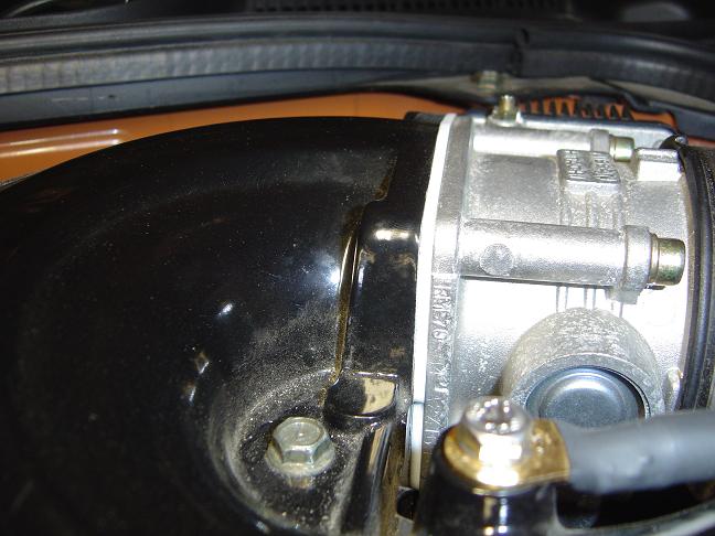

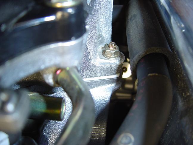

vfr350's Avatar
vfr350
Posts: 281
From: chicago burbs
Its purpose was to insulate and seal, it was just alot easier to slide to new gasket over the old, instead of having to scrape it off as it was stuck. The gasket was thicker than stock by far, and can even be seen inbetween the lower plenum and manifold. I will take pictures as well. I found gasket by someone elses recomendation on the board, but i can't remeber the thread or who it was. I still would recommend..

vfr350's Avatar
vfr350
Posts: 281
From: chicago burbs
Default gasket pics
So i'm not exactly sure of the stock material, and do not see how if it was sandwhiched how it would cause this not to work, as the Fisher speed gasket still provides the insulation or isolation between the two. And must have deleted the other email already, sorry.

Old May 19, 2005 | 03:22 PM
Road Warrior's Avatar
Road Warrior
Posts: 2,669
From: cali
the way i would do it if it were my car is to replace the stock gasket with the new gasket since the old ones are made of metal and transfer heat. i don't think these were designed to be used with the stock gaskets but to replace them. yours will still work but just not how i would have done the install.
Old May 19, 2005 | 04:49 PM
vfr350's Avatar
vfr350
Posts: 281
From: chicago burbs
I'm not trying to start anything, but what diffrence does it make which metal surface it contacts, both would be equallly hot, right? Now I can understand your reason for sealing, but I figured since I had never used this before, if i had a failure on the road for some reason, I could just pull it out, less parts to carry, but this has been fine. I must say, i was a bit worried about the seal of this strange material. No sense pulling it apart again.....
