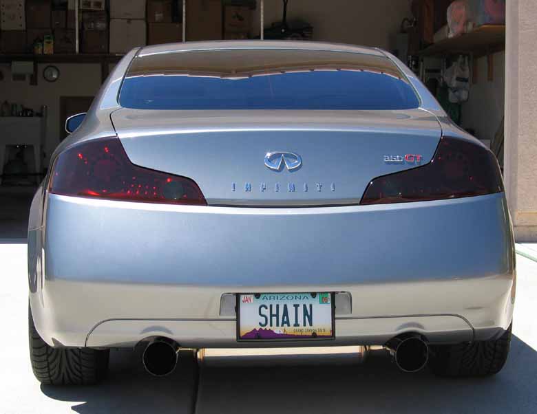

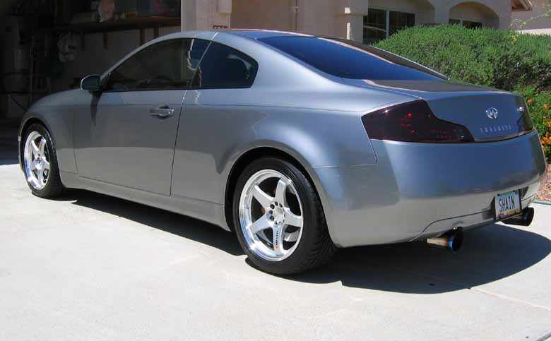

I'm another that fabricated an "H" into my Invidia G200 dual system. A beautifully made exhaust with great tone. Before the "H" the idle was somewhat lopey, after I added the "H" the idle smoothed out, and the tone became deeper and more mellow. The equalization smoothed things out.
Lou
Attached Thumbnails indepth *?* about exhaust systems-h-pipe0.jpg   indepth *?* about exhaust systems-img_side-invidia.jpg   indepth *?* about exhaust systems-rear-invidia0.jpg
