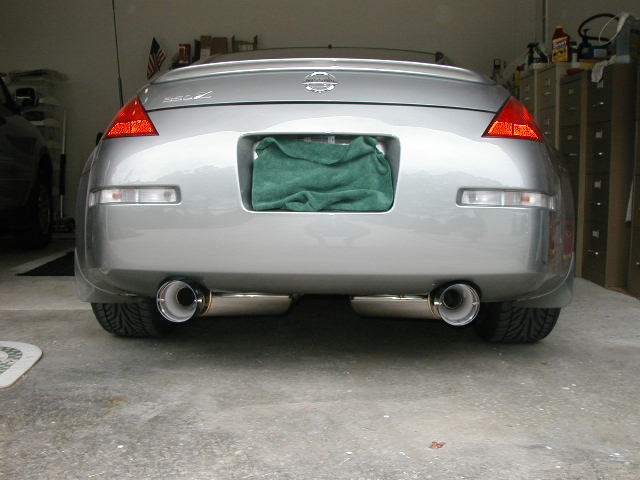

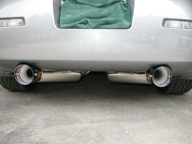

I had an unexpected favor to do this morning. I had to help my brother-in-law put a new motor mount in his camry. I've got to go to a baseball game tonight, but hopefully tommorow I'll have a chance to get the pics up somewhere.
Trending Topics
Originally Posted by ___DJK___
lol @ towel on license plate!
Hey man, take off your rear splash guards! Looks good!
Plus I was in a rush to take the pics this morning as my cams batteries were going dead. The towel(nice micro-fiber so no scratches
) was the only thing handy to block the plate. Besides...I trust no one... As to the splash guards...I've thought about removing them, but last week our "hickville" county road department decides to do a "redneck repave" on my road by first hosing it down with a tar/oil solution then dumping several truck loads of that white powdery gravel over it
