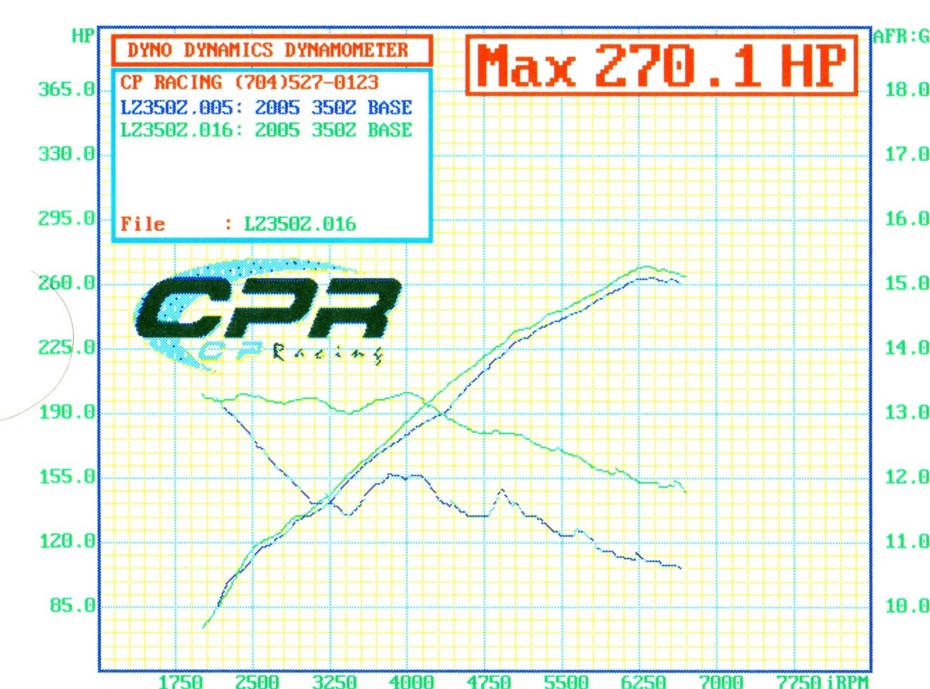

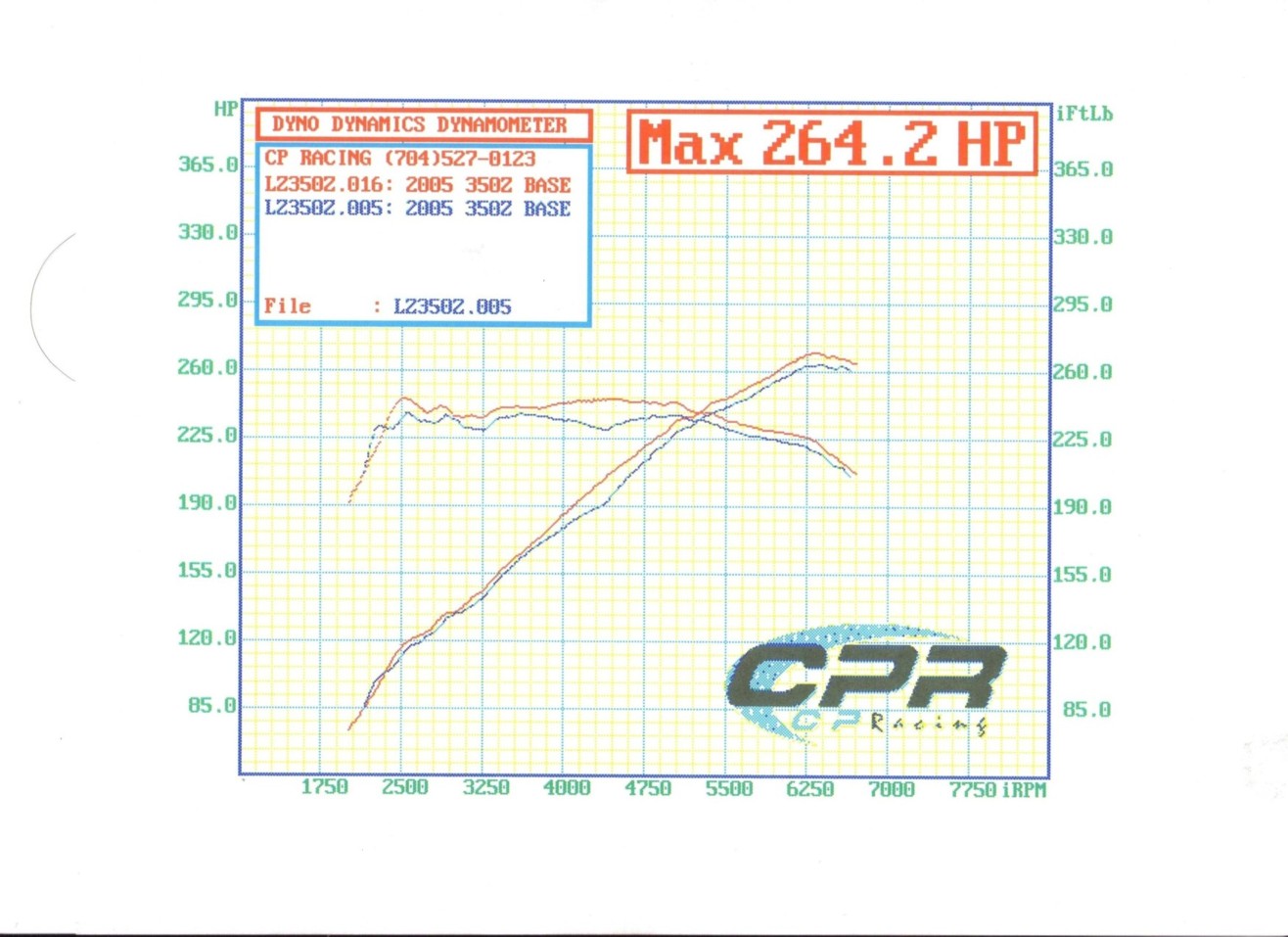

264whp stock 35th An 350Z Today I took a drive down to CP Racing to get a base Dyno for my stock 2005 35th an 350Z. I wanted to see what this "NEW" engine would be putting out before I started bolting on mods. Sharif was there with all the guys from Cp Racing, we were all guessing somewhere in the ball park of 225 thru 240 at best. The car ended up pulling 264.2whp on the best run. I had a set of Kinetix test pipes with me (resonated ones) so we thru those on and got a 270.1 whp on the best pull. The car kept pulling higher numbers each time we ran it untill it toped off with the numbers posted. Stay tune as in a week or so I will do another dyno with the HKS Ti dual exhaust, and possibility a APS kit to follow that(If Sharif can talk me into buying one of them). Big thanks to the guys at CP Racing and Sharif for taking time off thier current "BIG" project to mess with my car.
I will try to post the Dyno sheets tomorrow to include the Air fuel Dyno.
Kinetix test pipes (resonated) 6hp gain and good torque gains, dyno butt is happy, no rasp at all..

They add 13% to the number so it is comparable to dynojets. Your numbers would have been 229.68 without the correction factor.
Originally Posted by CpraceZ
The reason we have the corretion factor is because in our area there are a lot of dyno jet dynos in this area, when people talk hp around here they talk dyno jet numbers. A lot of people in this area don't understand that load bearing dynos read lower yet they are better for tuning. The main thought that goes through their head is wow their dyno reads low lets go someplace eles. That is the reason we do the correction factor. We use about a 13 percent correction

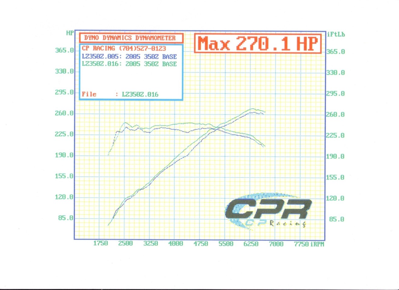

Here are the Dyno sheets
1.A/F
2.Kinetix test pipes resonated
3.Bone stock
Attached Thumbnails 264whp stock 35th An 350Z-fuel2.jpg   264whp stock 35th An 350Z-kinetic2.jpg   264whp stock 35th An 350Z-stock2.jpg

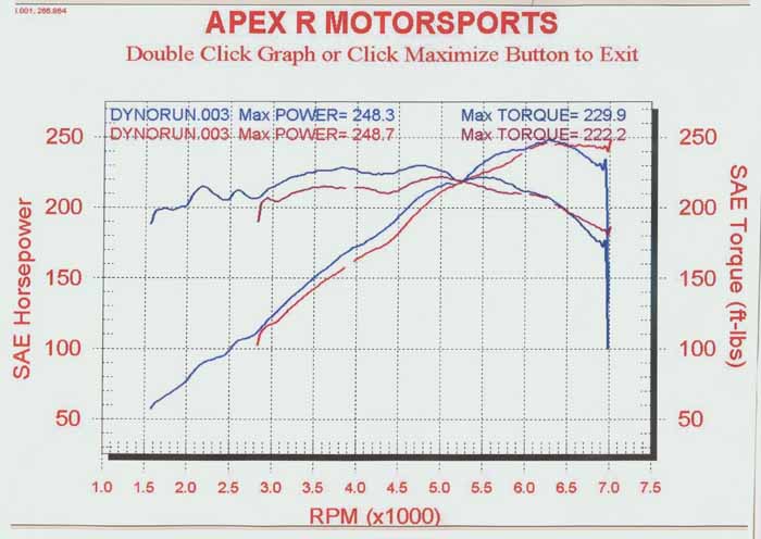

mikz
You I agree with and believe you:
Attached is my Dyno sheet:
Back to Back Dyno - '03 6MT modded "G" vs. '05 Plenum moded only 6MT with "Z" Tube "G"
My car is a 2003 "G" 6MT Coupe.
Mods:
TechnoSquare Crawford Reflash ECU
JWT PopCharger with "Z" Tube
Crawford V4 Plenum
Crawford HiFlow Cats
Crawford Headers
Invidia G200 Dual Exhaust with "H" Pipe
Ground WiresBack to Back Dyno - '03 6MT modded "G" vs. '05 Plenum moded only 6MT with "Z" Tube "G"
I've attached the results My Lines are Blue, the 2005 with the Motordyne is Red. We peak about the same 248HP, but I peak 7-1/2 pound feet of torque higher then him. And if you look and the curves, I beat him in all the power ranges up to about 6000 RPM, we look the same from 6000 to 6500 where the new plenum runners, ECU and cam take me by about 1/2HP.

if that is 35th anniversary why the rev did not reach 7100rpm?
Why rev it to 7100rpm? Once peak hp has been reached its just going to fall. I dont think its going will spike once it falls.
Old Jul 31, 2005 | 03:57 PM
sentry65's Avatar
sentry65
the burninator
Posts: 9,722
From: phoenix, AZ
yeah on a dyno it'll probably fall after peak power
in real world driving, you want to hold each gear as long as possible
