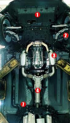

notice that the y-pipe does not have pre-cats. Or is that thing on the y junction a precat?

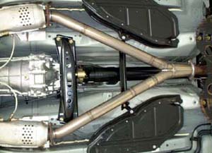

and the aftermarket pipe....

ooops ...here it is

I think that is the cat, and the 2 things labeled 3 are the precats. I am not sure, the exhaust is a lot different than the Maxima's, I guess I could raise both and look. The Maxima y-pipe is much different, check out Stillen's site, or Warpspeed performance's website for pics. From what I have been told, Nissan uses precats on all VQ engined cars, for emmisions....

Originally posted by roberto350z
ooops ...here it is
where is this y-pipe from?
Top Secret of Japan
www.topsecretjpn.com
