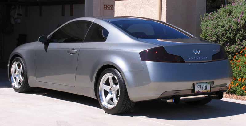

I built my Custom System based on an "X" type MagnaFlow muffler. After a little more than a year I couldn't stand the drone anymore. I tossed it and put in an Invidia G200 with an "H" Pipe. No more drone, more power, and it sounds great.
As was said above, I've been there, and it's not worth it. Buy a good after market system. There is a lot of them out there now.
Lou
Attached Thumbnails custom exhaust, universal mufflers?-h-pipe0.jpg   custom exhaust, universal mufflers?-painted-bumper0.jpg
