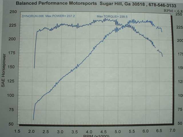

cost 260 for the muffler and to have resonator removed.
cost 30 to get the resonator put back on (didn't like it off)
cost 120 for the y-pipe,
now the bad news.
lost 4hp and 2.5tq. however up until around 5200 rpm, had a slight increase in both. looks like about a 10hp drop at 6350.
posting new graphs in separate thread.
my wife thinks its the gas I bought at an independent exxon/convenience store. she doesn't trust them and thinks its not really premium. I think I will have a nice starting point for the nismo or other company's chip.

Haven't checked the new thread yet but was the Dyno all spikey looking like it went into KR?
I had some bad gas do that to me on a Dyno, a bottle of Fuel Injector fluid and two tanks of Union 76 and it went back up to show gains (this was on adding MAC Headers with an ORP on an LS1.)
If changing the Y-Pipe causes 4-10hp loss all the way up to the 6k range I will probably have to pass on that, I was set to do it too!
Have to find your new thread and subscribe to it.

no it was less spikey than the original, figured it was the hyper ground working.

Old Jan 7, 2003 | 07:33 AM
2003z's Avatar
2003z
Posts: 4,959
From: Atlanta
here's the latest dyno, and illustrates the spikes.

Arrow My Dyno looked like that to once
It was determined to be Knock Retard from Bad Gas. I checked my fuel pump first to rule that out.
It shouldn't be that spikey. It looks like it is either searching for gas or air or fuel when it maxes out at the top of the chart.
It wants to climb higher but goes into KR. That's my observation anyway.
Old Jan 7, 2003 | 07:42 AM
  #38
12SecZ's Avatar
12SecZ
Posts: 4,686
From: NOR - CAL
Default That one is spikey too
Not all the way through the whole band though.
Hard to say, too rich, too lean, not enough fuel.
Did you ever do a stock Dyno before the CAI?
Just curious what it would have looked like.
Think I will do one now on mine before I go any farther. I will upload it next week. See what it looks like PRE CAI.
Could be messing with the MAF?
I'll catch up on this later today after some sleep.

1st dyno, even more spikey!
https://my350z.com/forum/showthread....threadid=15159

Hmm... so Y-Pipe and muffler (without losing resonator) should run around $350... not too bad.
A little worried about the dynos though... are you going to go back after you cycle through some good gas?
Also, do you think the design of the Y-Pipe (the two 90 degree turns) could be hampering HP? I know you are using 2 1/2" pipe, but the exhaust gases would still flow more efficiently in a straight line. (Damn... who knew my Fluid Dynamics class from college would ever come in handy again!)
It would seem with the two bends, you are creating two areas of back pressure in the pipe... probably doesn't change things much, but I think a loss of a few HP would not be out of the question.
Anyone with some thoughts on this???
