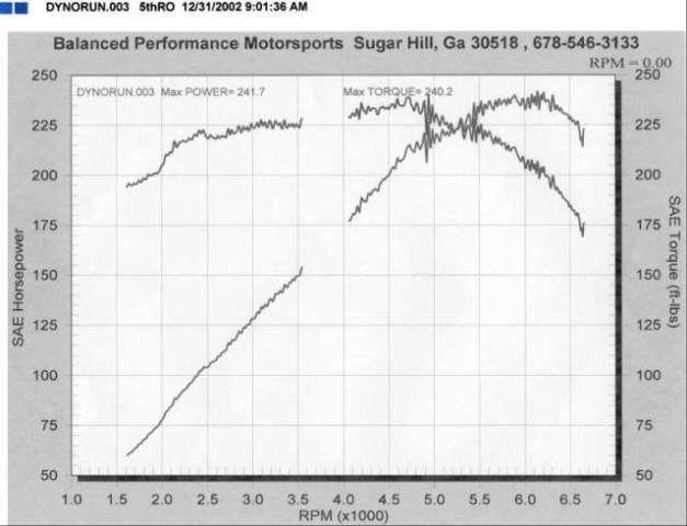

Default dyno results
Did it with just the K&N drop in after all. 5th gear, corrected to standard day. Tech said it looked like the ECU was cutting back the timing at 2500 rpm, and the fluctuations were similar to indications of pinging. The other 350Z they did, did not vary as much as mine. Topped out at 241.7hp and 240.2 tq. The other one they did in the past had 244hp.

How much did the dyno pull cost you? I might stop by that same shop just for comparison's sake.
I assume you're running 93 octane? Do you know what brand of fuel you filled up with last?

Did you reset your ECU when you put in the K&N? if not, that could be the reason for the pings

So are you saying there was a lost using the K&N filter, based off previous test?

To reset ECU, remove battery's negative terminal for 30sec to 10min, every car is different (simple way-step on brake til light no longer shines) then reconnect, fire it up and drive around

I put the K&N in the day I got the car, and had the battery disconnected for a few days when I installed the stereo, so I would assume it was reset, especially since its been in for 3700 miles now.
As for gas, I use QuikTrip 93 octane exclusively.
3 runs for $59.99, Z club of Ga. price, or coupon from their website.
[So are you saying there was a lost using the K&N filter, based off previous test?]
No, previous test was on a different 350Z, don't know what he had, but will assume stock.
