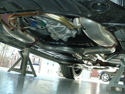

Default 3 pics of my 2.5" y-pipe

Nice! You couldn't replicate the Top Secret Y-Pipe design? It appears there are quite a few bends that may hamper flow?
Old Jan 4, 2003 | 03:10 PM
2003z's Avatar
2003z
Posts: 4,959
From: Atlanta
they are 2.5" pipes and the factory single is about 2.5" so I don't think it hampers that much! Stock looked less than 2" and wasn't mandrel bent either under the heat shield.
looks great! but there are (2) 90degree bends, will it reduce velocity flow?
was it not possible to do straight Y-PIPE? Just wondering.. Thanks..
Old Jan 5, 2003 | 07:56 AM
2003z's Avatar
2003z
Posts: 4,959
From: Atlanta
Sure, it would be possible to have them angled instead of having 2 bends I guess. They would have had to bend the prefabricated y-pipe though, and not sure if it would have fit in their bender. If you could find one that was a true Y instead of a U it could easily be more straight.

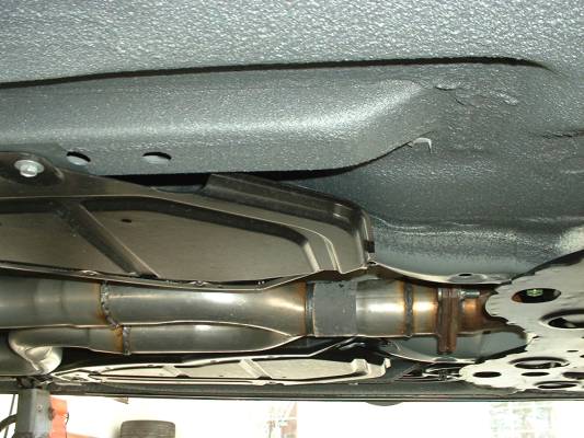

I did find this nice pic of the Top Secret Y-Pipe that shows the difference between it and 2003z's pipe with the two bends...
