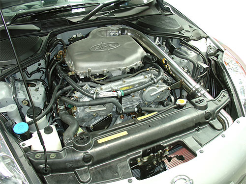

Looks pretty sweet, It's coming out sometime in April.

The location of the filter is not my first choice: Its behind the bumper rather than the grill opening.

Pic is pretty small, but it looks like this replaces the stock MAF tube with a port to install just the MAF hot wire element. If the diameter of the tube is larger than stock (looks like it), then this will potentially cause the MAF to read lower voltages and cause the car to run leaner than normal. You might get too lean if you have other mods such as headers.
