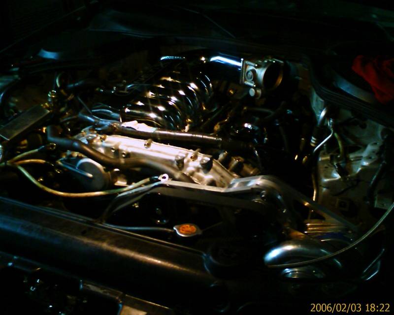

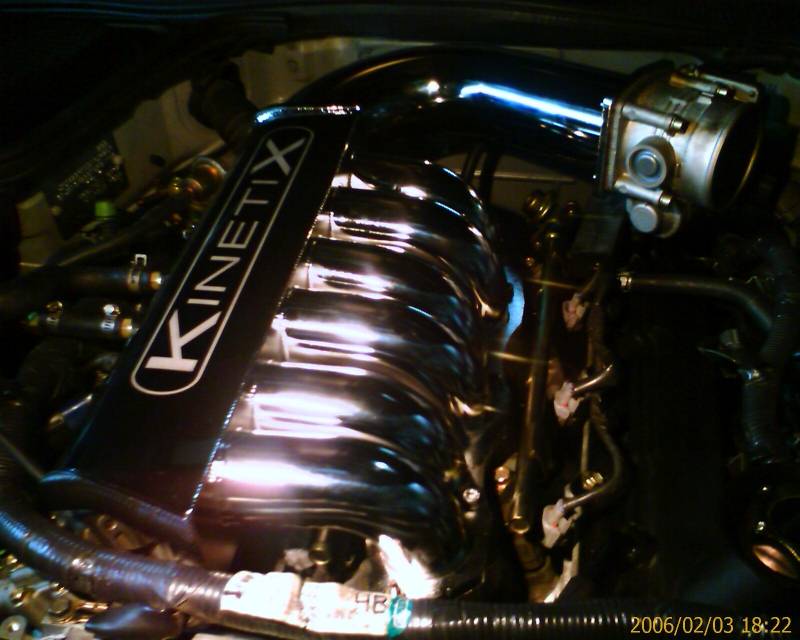

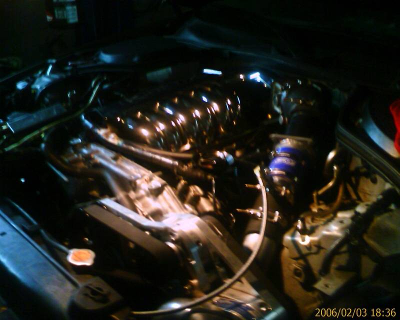

Here are some pics of my SSV install. You can also see the ATI Procharger in the front and the CryO2 cooling units.
