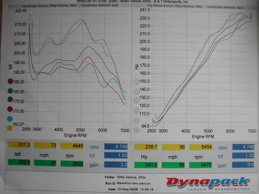

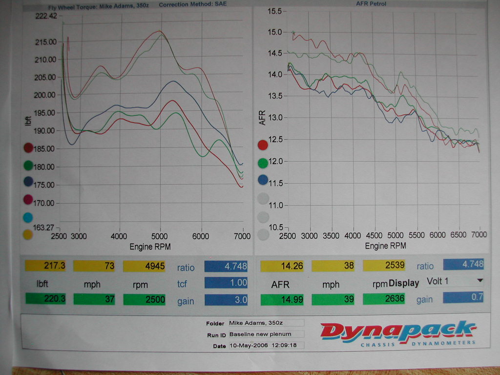

OK, took some smaller sized pics and used another host. I went to B & T Motorsports, on their dynapack, and was a little surprised at the low numbers. According to the techs though, what we saw at baseline was consistent with other Z's and G's run there. Apparently despite it being a Dynapack, they aren't using the same calibration factors as say Church's, lol. Anyway, take 'em for what they are, a measure of gains.
On both charts, the top 2 lines are post V2/spacer install. The strong blue line on the preinstall baselines is the 3rd run, I had 'em let me disconnect battery and pump brakes to see if it does reset the ecu. Looks like it does to me. Ah, and the 3rd run from the top (post-install) is not posted. We ran it in 5th gear but all others were in 4th so I didn't want to show an orange with apples.
Here's hp/tq:
and tq/afr:

from what your graphs show, IT WORKS!!!!
I hope we see similar results on more "revups"!!!
My MREV2 gets here tomorrow. I already have the MREV+5/16" spacer, and I love it. It looks like this modded lower plenum will give me some more!!!!

You're right, the numbers we got from Church's are bullsh!t but at least the gains are for real.
I'm impressed with your gains... I had a feeling the spacer would be the key.

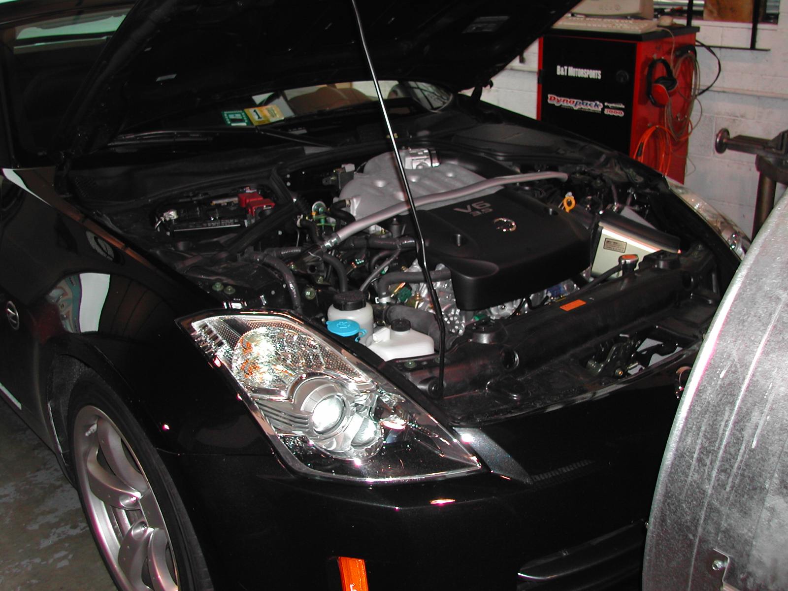

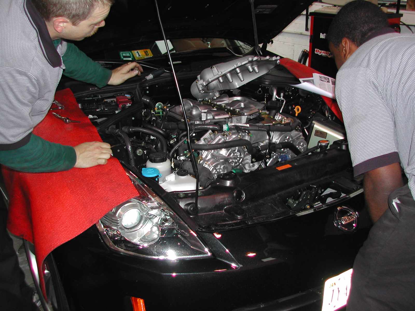

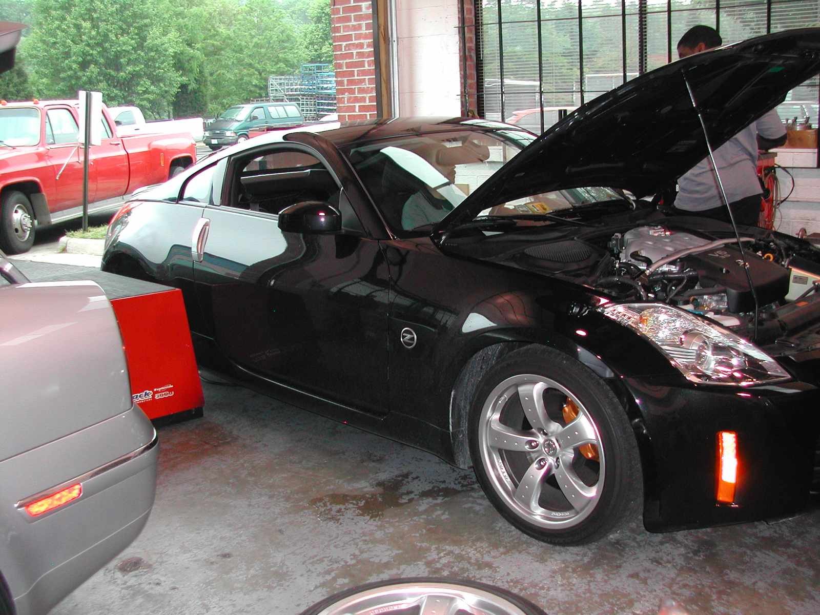

Heh, butt dyno is good. I gotta say, I'm basically feeling what a lot of the MRev+ guys were feeling. Great throttle response, smoother through the band, and a noticeable oomph when the car is told to go, with a little deeper growl. Unfortunately I haven't been able to really go ***** out, straights only 'cause we got a good amount of rain today (note the dirty car), but tomorrow should be nice for a drive.
Anyway, attaching the previously posted chart and a couple of others. Got one of in between baseline and the V2 install, one during install, and one during a run, post-V2 I think.
Ah, and FWIW, the baseline was popcharger and Nismo exhaust only, so pretty stock.

Excellent gains Mike! Now thats the kind of gains we all want to bolt on.
That's definitly among the best of what was seen on the MREV+.
Its not the highest, but then again, many more MREV+'s have been dynod.
One thing that looks different is you seem to have even more area under the TQ curve at the very low end.
It must feel much nicer to drive with gains like that.

lol, yup Tony, I wish they all made such a noticeable change to the feel of car. I heard the other 2 mods I have more than I felt 'em, so this is nice. And yes, definately some noticeable pull down low, of course in the early gears it's big, but I noticed on the highway on the way home that 6th was giving me some more response at cruising speeds/rpms. Just outstanding feel all around.
