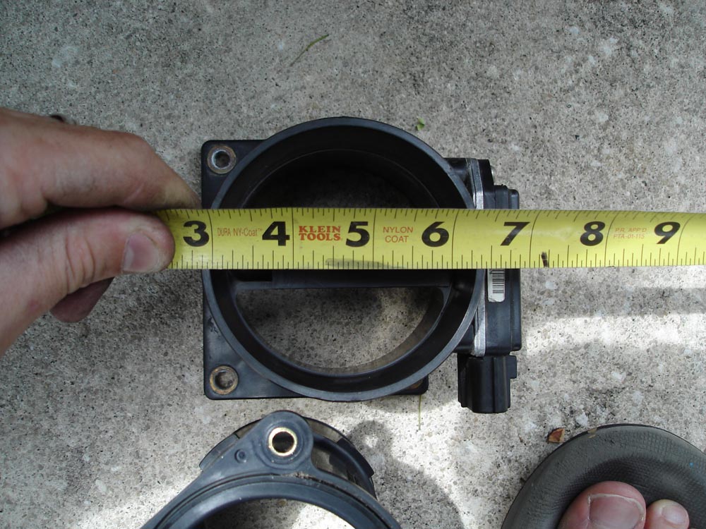

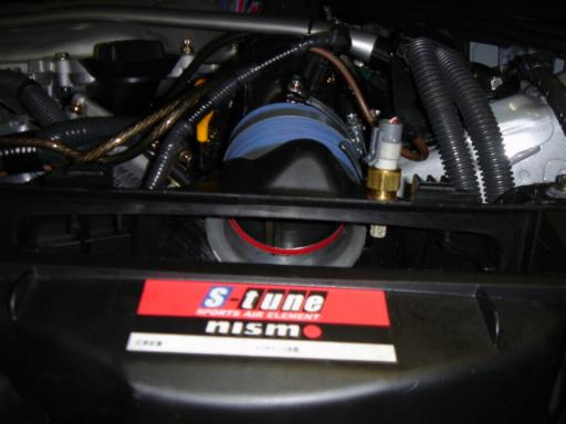

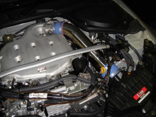

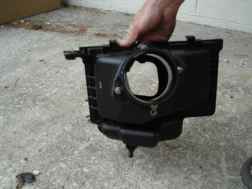

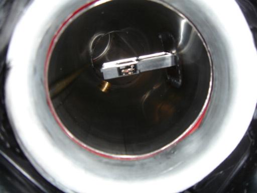

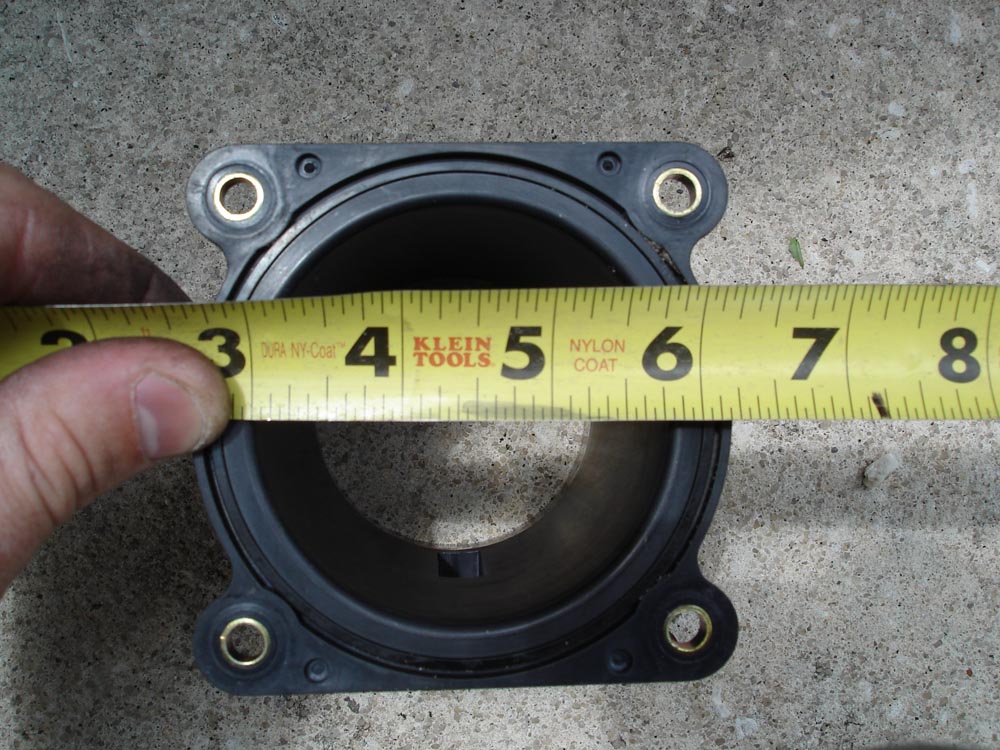

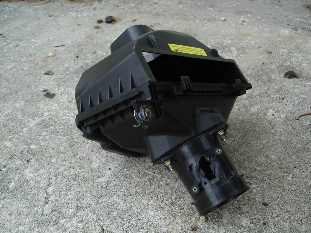

well the stock MAF housing measures 2.75 inches across. the stock throttle body is 3 inches exactly. even with a bigger bored out throttle body, you cant get enough air into the motor. today i decided to install a new MAF housing ( i went to the american performance shop and asked for a 5 liter mustang MAF housing, he said he had one in back but then he said it was off a 350, it doesnt matter which one, i am just not sure 100%, i will know tomorrow). i actually took the stock box and cut it out a 3.5 inch circle for the new maf housing. i got 3" inside diameter hose and tube to run up to the TB. i got it all installed and of course, it was idleing like crap. i added a bunch of fuel to compensate for the maf reading being low and got it to idle perfectly. now i need to scale the maf on the utec or wait until wed when my map sensor will be in and i can tune my NA car to speed density mode.

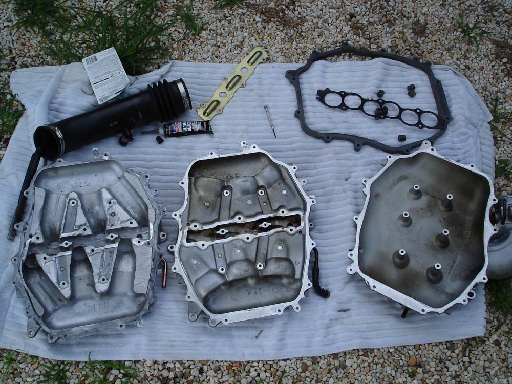

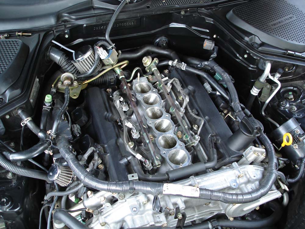

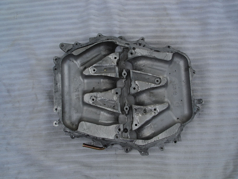

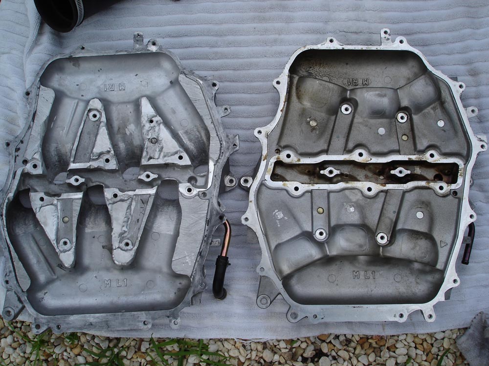

part two. i added my cut lower plenum. the car ran perfectly. i have an acelerometer and drove around before hand to see how many forward Gs my car would pull in 2nd gear at certain rpms. i then put in the lower plenum and the car amazingly lost NO low end (under 4500) it pulled JUST as hard. from 4500 to 5500 the car got really really rich 10.9 to 1. after 5500 the car got back to 12 to 1 and pulled like CRAZY harder and harder until redline. i didnt have time to tune it cause i wanted to get the maf housing in. i might grab the maf housing off and tune the lower plenum tomorrow. not sure yet
i am supposed to go to the dyno on friday. i am going to see what i can do with my maf sensor tomorrow and if i cant get it working right i will install my old setup back for the dyno on friday.
i really really have a good feeling about the lower plenum, and once the MAF sensor is figured out, there will be more air flowing in for sure...
i will post some pics tomorrow, i am just tired....

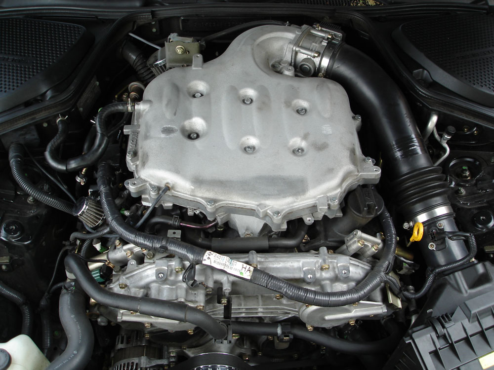

some pics....
Attached Thumbnails Larger MAF housing installed today with my cut lower plenum...-plenum1.jpg   Larger MAF housing installed today with my cut lower plenum...-plenum2.jpg   Larger MAF housing installed today with my cut lower plenum...-plenum3.jpg   Larger MAF housing installed today with my cut lower plenum...-plenum4.jpg   Larger MAF housing installed today with my cut lower plenum...-plenum5.jpg

more pics...
Attached Thumbnails Larger MAF housing installed today with my cut lower plenum...-plenum6.jpg   Larger MAF housing installed today with my cut lower plenum...-maf1.jpg   Larger MAF housing installed today with my cut lower plenum...-maf-2.jpg   Larger MAF housing installed today with my cut lower plenum...-maf-9.jpg   Larger MAF housing installed today with my cut lower plenum...-maf-8.jpg

Originally Posted by audiblemayhem
some pics....
Looking good.
So you still doing a before and after dyno with the lower manifold?

yeah thanks man, i am just happy to get it idleing perfect in only a few minutes... i think it will be easier to tune in speed density mode so i might wait till wed when i get my map sensor for the utec to set up. the maf signal is so much weaker now that there is not as much room for correction.
my maf housing measures right at about 86.2 mms
cant wait to get everything running right...

well yes the MAF will slide down in any tube yes. but the maf calculates how much air is flowing into the car. it calculates this through a 2.75 inch tube. when you put it in a larger tube it doesnt pick up as much air cause more can flow around it sooo.... you have to have a computer that you can tune it so it calibrates correctly. im sure you know this. just letting other people know they cant just go out and get a big pipe and throw the maf in and work righ
