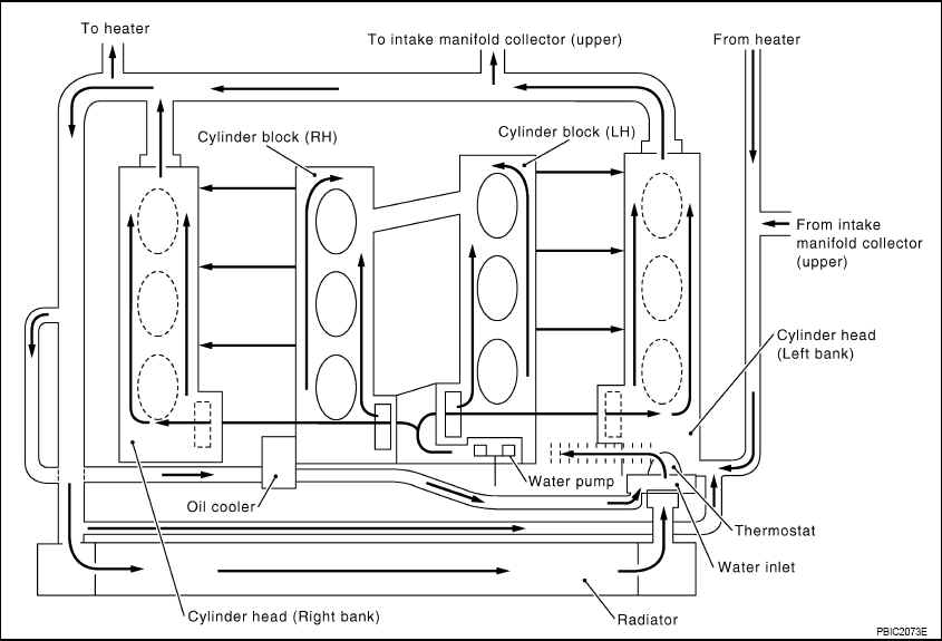

Can any damage occur by blocking the coolant from reaching the throttle body with the by pass valve? It would seem that pressure would build at the blockage created by the valve when in the off position. Has anyone had any issues with this?

It's unlikely as there is no real pressure in that line. This same mod has been around on many other cars for several years. So long as you don't let a large amount of air enter the hose from either side of the shut-off valve there should not be anything to be concerned about.

No damage will occur. That line diverts a small amount of water flowing from the block than ultimately goes back to the water pump. It's similar to the heater bypass line. When the heater is off, no water flows through it either.
Check out the diagram from the FSM...

Good info. Thats what i love about this board, knowledgeable members.
