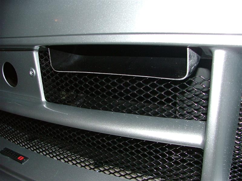

here is a scan off the box. i have got that combined with a velocity stack and an external V2 air scoop all going into the all mighty 5/16 motordyne spacer
Looks pretty good. The main difference seems that the popcharger venturi is like a huge bell shape, more optimal than the 06 velocity stack.
Maybe I should do the varis duct for fun... get some cooler air up there.
I took a good look at the popcharger venturi and the 05 airbox. It looks POSSIBLE to mount the venturi, but I am going to need an extra air box (one that I can cut up) to make it fit.
Reason being, I would put my stock airbox back, remove the popcharger, and try to mount the venturi in the new box.
Either that, or someone would have to give me their venturi...
Anyone know someone who doesn't want their popcharger or airbox anymore?

anyway you can try the stock air box, and the v2scoop? maybe buy it off EVoR and trim to fit stock bumper.. i really think you'll get better airflow #s with that scoop thats near the license plate than the mine's / varis duct. air pressure is much higher there in front of the nose and will force more air into that airbox.. at speeds than your pop charger alone....
did you map the intake temp sensor's @ idle and at speed?

do you think enclosing the pop charger, similar to zquicksilvers, and getting a better seal to the front intake inlet would achieve better results?
since the stock box is totally enclosed, and sealed to the intake inlet this creates more of a suction imo.
you can pick up airboxes here for around 30 bucks shipped if you wanted to try your other experiment using the ring from the pop charger.
is the stock airbox thick enough to thread the holes for securing the venturi ring from the outside using bolts, possibly plastic bolts. either that, or have plastic threaded inserts welded into the stock airbox for the plastic bolts to secure the ring from the outside. i have seen these on rc planes to hold the wings to the fuselage...just a thought. you could find these at a hobby shop.

The only thing sealing it up would do is keep hot air out.
All the suction goes on at the venturi ring. As long as there is air around that area it will have no problem.
