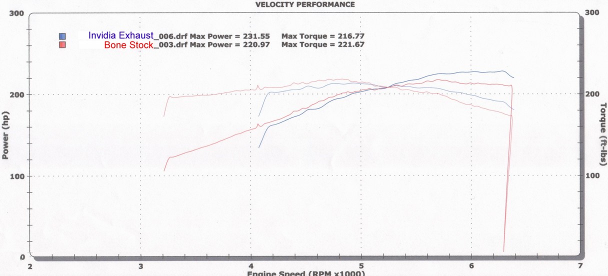

I voted Invidia G200 for your application (6MT). I've had mine for over a year and half.
Here's my dyno for my 2003 G35C 5AT. I lost HP and TQ below 5,300 RPM, but made up for it on the top end.
http://g35driver.com/forums/attachme...7&d=1127591945
My 5AT shifted funny after the exhaust. Earlier this year I added a custom H-pipe and have some of the TQ back in the lowend.

Originally Posted by 3FITTTY
went with G200, thanks guys.. Ill post pics and sound clips in a week or 2 after i install..
I just noticed in one of the posts the dyno chart shows a drop in torque with the G200 system. I'm wondering if you will notice this....just curious. Let us know what you think after it's installed.

^ will do, but i plan to get an H pipe welded in, that should fix the drop in torque..
