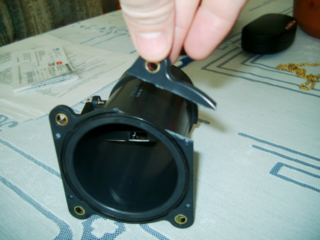

hmmmmm, I vaguely remember when I installed my pop charger on my 03 Z, and I remember not drilling any holes, and just resting it up against the inlet hole. I do remember installing the heat shield (PITA) and breaking the bottom bolt on the MAF tube area as well, which I WILL NOT do again,
