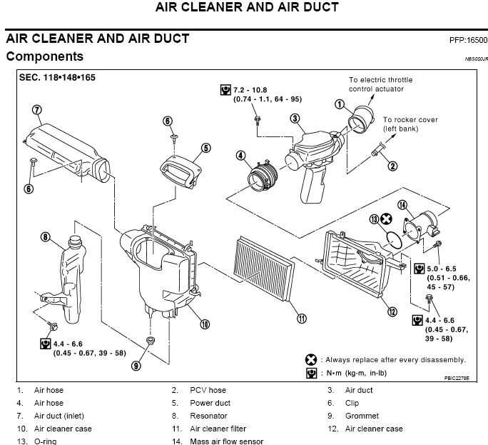

Yes I searched and I've also posted this over at g35driver.com but noticed this o-ring is also present on the 350z (according to the service manual)
hey so I installed my JWT filter and OEM ztube with no problems (except the rubber on the heat shield was kinda a pain). Just for fun I was looking at the service manual and noticed there is an "O-ring" between the MAS and the air cleaner case that should be replaced after every disassembly. I have attached the diagram from the manual and the o-ring is item #13. My question is does anybody remember seeing this? I don't remember seeing any O-ring when I did the install and now I'm kinda worried sorta...

Don't worry the O-ring will be fine.
If it's dry or cracked, replace it.
But 99% of the time it will be fine.
I think I vaguely remember seeing it, but there was nothing wrong with it, and it's rubber so there's no need to replace it...

thanks for the quick reply - i just removed my filter and sure enough there it was ... hahha... don't know how i didn't notice it the first time around. thanks again.
