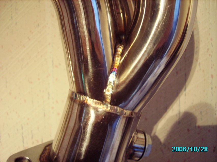

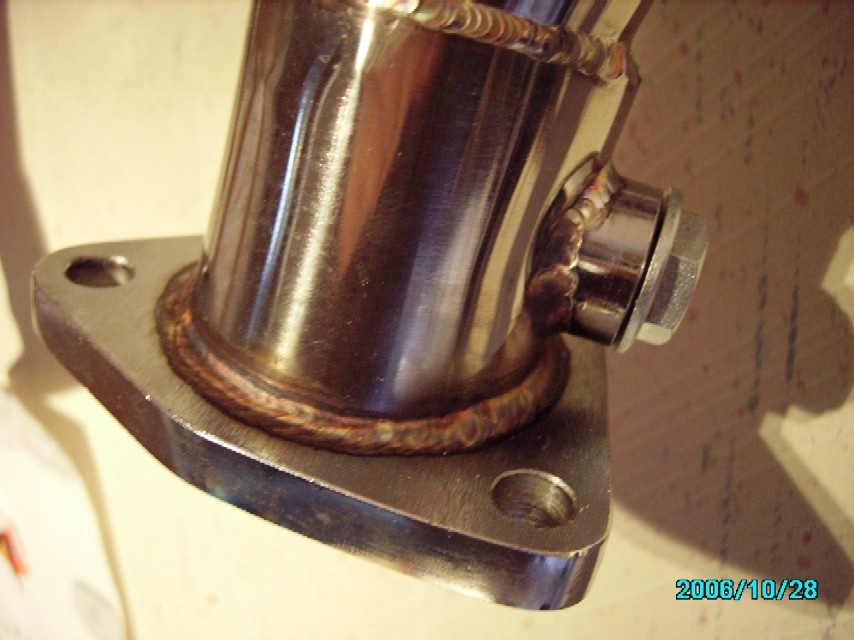

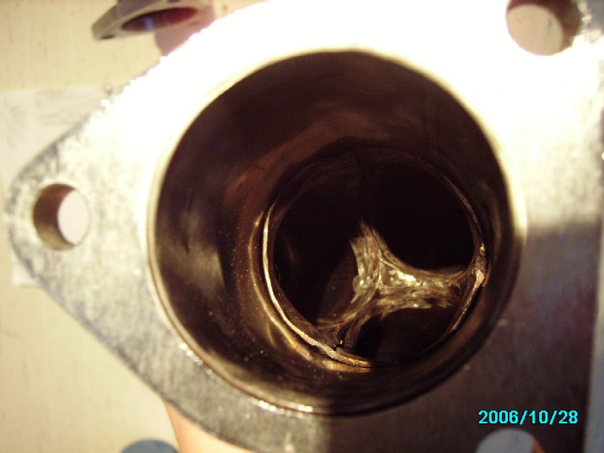

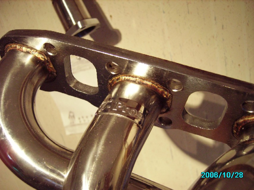

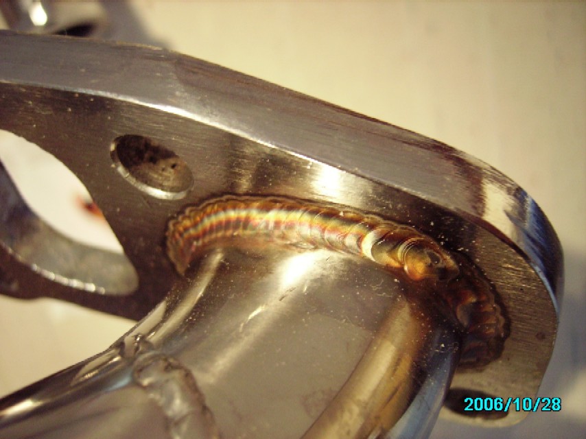

Going to start today the install of a set of Tpros Headers I got from ebay 92.00 shipped!! and I have to be honest they do look very good all the welds ar nice with good penatration just all in all good set now weather or not the fit worth a damn is another story and I will let you all know.
I know they are here but I will anyway post some install pics just to do it and I am only going to remove the min. amount on this install just because thats just me, this will be done on stands no lift and might I say on gravel not pretty but at least its dry where I am and that is a plus with the weather like it has been here. hope the pics work out.

Thank God for mechanics gloves!! trashed and new pair completely but all in all a good time, completly done by my self no help at all in about 13 hours total.
I did have trouble on the cat bolts at the y pipe they were just little ***** of rust (for a 03 not bad though) but no trouble with a 90 and a cut off wheel, the cat brace was the same way i just cut the brace close to the bolts and got them out when I had the cats on the bench then migged up the brace when I was done, drivers side removed the steering u joint from the rack and left it on the shaft and the header went right in, pass side removed the water line manifold and drained the antifreeze there is still a bunch that runs out when you pull that line apart as much as runs out of the radiator but it fit like a glove sounds KILLER and no leaks at all, getting the air out of the coolant system is and has been a task but it is allmost gone still some in there.
a six point 9/16 works well on 14mm and saved my a$$ a few times I had no swivel sockets at all just a u joint and wrenches.
the sound is great for the money it was a hell of a deal!
