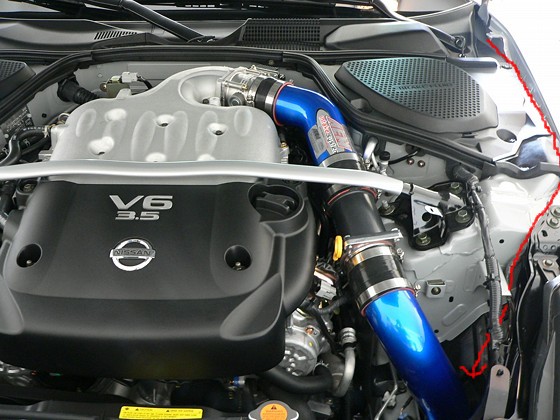

As for a pic, this is the only one I have of my engine bay with the AEM.

Actually, if you scroll up you'll see a snapshot of my engine bay. This is a little tough to put into words, but I'll try. Actually, no I won't. Here's the same pic, except I drew in a red arrow to show the path of water I see when I open the hood after it's been in the rain. Basically, it starts at the top by the windshield and then trickles down per the red arrow.

Ah, I see. Interesting. Let me look at my 03 and maybe we can pinpoint the difference.
But FWIW when I open my hood when it's been raining, water seems to head from the hood straight for my JWT. So perhaps I'm no better off. lol
