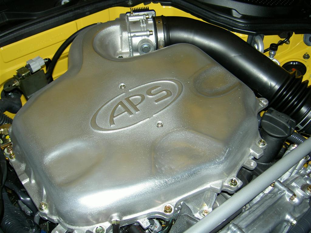

I would bet you wouldn't see any difference in engine output. Those posts can't occupy much volume. Having said that, the APS plenum has just 2 interior posts, and it does make more power, however I believe that's from the added height at the front, hence you have to use a different strut bar. And you would have to weld or bondo 6 holes = ghetto.
Attached Thumbnails cut interior posts off of upper plenum?-pict1245-large-.jpg
