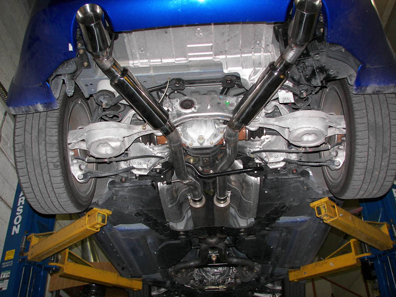

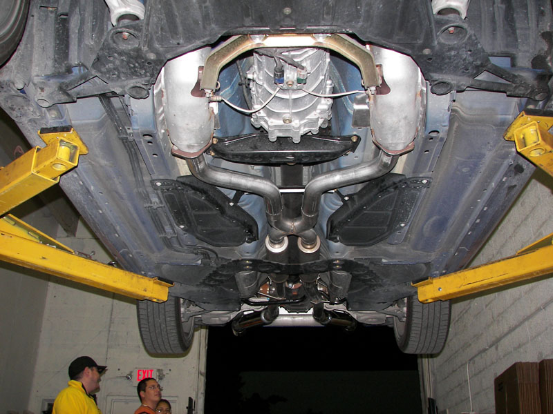

Decided to go with a custom x-pipe setup for my car after researching some stuff on the boards. The shop that did the work was Exhaust Depot here in South Florida. I'm pretty happy with the way it sounds a idle and throughout the RPM band. Believe or not I have no mufflers, just a X-pipe and 2 resonators on each side. Pretty quiet, thinking of putting some resonated test-pipes later on.

Looks nice, do you have any other pics of the X-section? i'm curious as to how it looks?

Thanks for the photos from under the car. With the pipes as straight as possible, its a clean looking set-up.

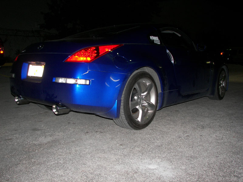

loos nice man are those the stock tips

No, those are some Magnaflow 4" tips believe it or not.

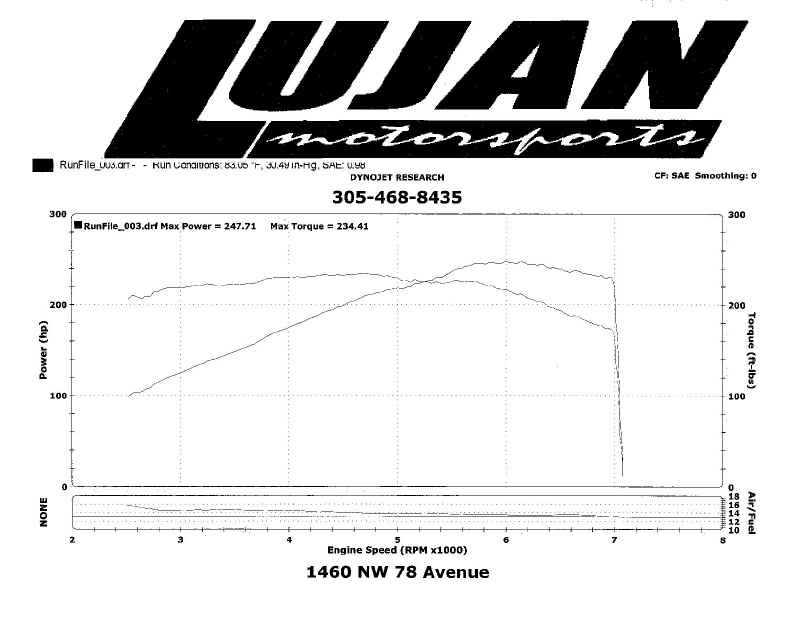

Was by a Lujan Motorsports today with a friend asked if he'd mind strap me in for some quick runs. The car originally dyno'd 236whp and 209TQ on a AWD dyno uncorrected.
MODS:
K&N Filter
MREV2
5/16" spacer
2.5" True Dual w/X-pipe.
Out of 3 runs Best was-
uncorrected: 254 WHP/ 240 TQ
SAE corrected: 247WHP/234 TQ
1st Run was 241WHP/229TQ, 2nd Run 246WHP/232TQ SAE (Forgot what the STD was)
If you compare uncorrected to uncorrected I gained 18 WHP and 31 lb/ft of torque.

If you look at the dyno sheet, the HP plot takes a nose-dive after 6k RPM. I think thats kinda odd since you got the 5/16" spacer. I thought the spacer would add topend power??

The drop in HP corresponds with the ecu trying to correct the AFR back to 14.7. Look at the bottom of the graph and you'll see the AFR and how it rises from ~13ish up to almost 14. And no, this is not a "lean" condition - this is normal, though it certainly doesn't help with power.
Looks like it's time for a tune!

Yeah I suspect I do need a minor tune, just not enough for me right now to go for it. Still contemplating if I should a attempt a bolt-on record then supercharge it, or stop at this point and save up for a turbo. The next item on this list are Resonated Test Pipes. I find it strange that the ECU is trying to do this already with only 3 mods (really 2.5).
