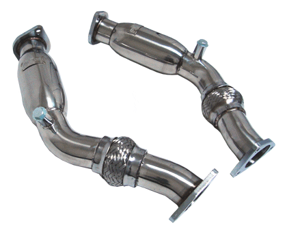

I just got the new Megan test pipes and they look very nice and with the flex section I don't think I will have any issues with cracking. Plus they come with the 02 sensor fix already welded on.

Hey I just put on those exact megan test pipes with the flex pipe and CEL fix and after about 2 days of driving the CEL still came on due to the cats. the code said that it was getting Low readings. Not sure what I want to do yet. Any comments?

I have the new version of MR test pipe also. Over 1000 miles so far, no crack no problem. I don't even need the non foulers, the O2 extension took care of it.
